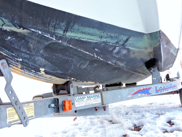

My bunks are 29" on center and they line up perfectly with the hull to hold in place.
Fig. 2. Detail of hull and trailer bunk alignment.
I may swap out this keel roller for one without edges, but it does a great job when launching in shallow water and guides the keel.
Fig. 3. Keel roller close up.

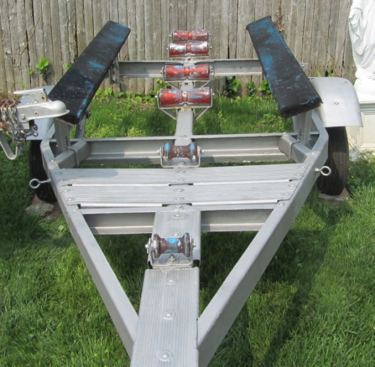

The trailer shown in Figure 1 has a nice set-up with several keel rollers and lateral bunks.
The trailer shown in Figure 1 trailer has straight-across cross-members. That feature makes installing keel rollers quite simple because there is no problem with the vertical height of the keel rollers not being sufficient to meet the boat's keel.
As general concept in orientation of a Boston Whaler boat on a trailer, the boat should be carried as low as possible on the trailer. If that is done, then the launching depth is reduced, which helps launching and loading on ramps. The center of gravity of the boat-trailer rig is reduced, which should improved stability of the trailer at highway speeds and possible help reduce sway in crosswinds.
A boat trailer's maximum width will be at the wheels and fenders, and typically a boat trailer will not exceed 8-feet six-inches width. That figure is generally the legal limit for width of a trailer than can be towed on the highway without special over-size permits or special escort vehicles.
For larger Boston Whaler boats, the limit on how low the hull can be positioned on the trailer will usually be determined by the relationship of the hull chines to the top of the wheel fenders. For example, on my 22-foot Boston Whaler boat hull, its position on the trailer has been carefully adjusted so the clearance between the hull chines and the top of the wheel fenders is only one-inch. I have seem some rigs with even less clearance, but one-inch clearance seemed close enough for me.
For Boston Whaler boats whose beam is small enough to fit within the wheel fenders, there won't be much trouble to get a nice, low mounting height of the boat on the trailer. I believe that a SPORT 15 classic hull ought to easily fit within the wheel fenders, unless the trailer was made narrower than 8-feet 6-inch maximum width.

The aft keel roller as seen in Figure 3 could be wider. A wider keel roller at that location will be very useful when loading the boat. If during loading the boat orientation misses a narrow keel roller at the far aft end of the trailer, there will be a risk of the hull being damaged by hitting some metal part of the keel roller assembly.
The transom of the boat should be right above a keel roller if possible in order that the weight of the transom bears directly on a support. This is not particularly important in launching or loading, but once the boat is out of the water and on the trailer, the very aft end of the keel at the transom should be supported directly from below.
