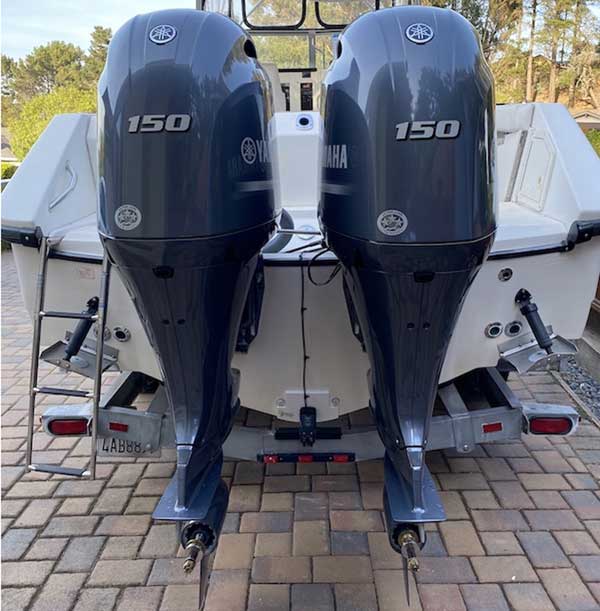

I decided to re-power my 2001 23 Conquest with twin Yamaha F150 engines. A deposit was made in November 2020, and 11 agonizing months later, the new engines have finally been delivered and mounted, as seen below.
Fig.1. New Yamaha F150 engines installed on 23 CONQUEST
Fig. 2. View from astern.
The Yamaha F150 engines have a gear ratio of 2:1. The F150 engines produces a propeller shaft horsepower of 150-HP at an engine speed of 5,500-RPM, and the recommended full-throttle operating range is an engine speed of 5,000 to 6,000-RPM. The engines are mounted in the lowest position possible. The PORT engine is a counter-rotation model.

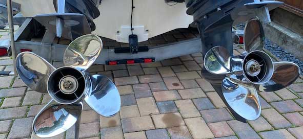

Now I need propellers.
Please give me a short list of propellers to use with these engines on a 23 CONQUEST.
The dealer who installed the engines has ordered a set of temporary 17-pitch aluminum propellers for he and I to test with the boat. We are awaiting these test propellers. Once we have these test data with the 17-pitch propellers, he plans to order a final set of propellers from Power Tech. He hasn't shared with me the exact model by Power Tech model but I told him that my preference would be four-bladed stainless steel propellers. Before he orders the final propellers, I want to be confident in his decision.

I suggest using Mercury REVOLUTION4 17-pitch. They should give stern lift.
I like the Rubex hubs to quiet the shifting sounds.
Visit Propgods.com for excellent propeller information and a website to ask questions. Propgods ships propellers for testing through the mail for a reasonable fee, so the buyer can make-up his mind.

Conch-- I heard of Propgods long ago but wasn't aware they were still around. I'm checking out their forum now and there's a wealth of info there. Thanks for the tip.
Regarding the REVOLUTION4 propeller, I actually bought one long ago to try with my Mercury 135-HP engines. Out of the box that prop was big and heavy. So much so that I never bothered testing it on that 135 mid-size Merc. The F150s seems to be in the same class as the Merc 135.
You don't think the REVOLUTION4 is too much prop for this gear case?

The REVOLUTION4 is a very big, very heavy, very hard to turn propeller. I would not consider that a 17-pitch REVOLUTION4 would be the same engine load as a typical three-blade 17-pitch propeller, and UNDER NO CIRCUMSTANCE would I think that a 17-pitch REVOLUTION4 would be the equivalent to an aluminum three-blade 17-pitch test propeller.
The RUBEX rubber hub kit is a good replacement for the FLO-TORQ II Mercury hub kit.
The suggestion to get advice from Ken Reeves at PROPGODS is good advice, but that should not foreclose further discussion here. Also, you better verify with your dealer that his offer to provide test propellers will still be good if you decide to buy the final propellers from PROPGODS.

As seen above in Figure 1, the new engines are mounted in the lowest possible position on the transom of the 23 CONQUEST. The engine mounting height is an important factor in performance and propeller testing. You may want to closely observe the location of the anti-ventilation plates of the twin engines relative to the flow of water around the gear case when you get the boat underway with the test propellers. Raising the engine mounting height may be something you and the dealer should discuss.
Also, the weight of twin four-stroke-power-cycle F150 engines on the transom is like to affect the static trim on the boat, particularly on a 23-footer. You may want to consider reducing weight in the stern of the boat to compensate for the increase in engine weight.

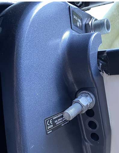

[The engine mounting should be] at least two-holes-up to begin [testing propellers].

The engines are mounted at the lowest position. This locates A-V plate right at even with the hull or 0.5-inch below the hull. I should have consulted the dealer about this before the installation, but this was one thing I forgot to bring up. I'll just test them as-is now and see how they run.
Fig. 3. Close-up on engine mounting showing lowest possible position, as explained in the text.

I think the engines will surely need to be raised.

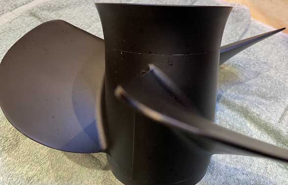

Fig. 5. The Yamaha aluminum three-blade propellers are marked 14-1/2 x 17-pitch.
Fig. 6. There seems to be a little [blade] cupping.
Blade cupping might be a contributing factor to the propeller's effective pitch.

I have completed another round of propeller testing on San Francisco Bay. The propellers tested were a set of PowerTech OFS4 four-blade stainless steel propellers 15.25 x 15-pitch. Taking these propellers out of the box they felt heavy; I weight the propellers with the added Cushion Lok hubs on a bathroom scale: 16.4-lbs per propeller.
The OFS4 propellers did not work out well on my 23 CONQUEST boat. With a 15-pitch the Yamaha F150 engines speed seemed like the boat was under-propped. At a top boat speed of about 45-MPH, the engines were (likely) hitting their rev-limiters at 6,100-RPM.
There was a vibration coming from the engines which could be felt at the helm when running at speeds greater than 1,500-RPM. I do not know the reason for the vibration but it almost felt like the propellers were not balanced.
There was no CLUNK shifting in-and-out of gear with these propellers. I believe this is due to the impact absorbing Cushion Loc Hub fitted on this set of propellers.
I did not feel these propellers were good for my setup so they were boxed up and sent back to my dealer. Decided I will just buy the Yamaha tree-blade aluminum from my dealer and just run them for the time being. I'll revisit upgrading to stainless propellers next spring when there are more boating opportunities.
An interesting note. Yesterday I received a phone call from my dealer that one of the OFS4 propellers was actually a 14-pitch instead of 15-pitch. Apparently PowerTech put the wrong propeller in the box. So the performance data collected here with the OFS4 is flawed.

Fig. 8. PowerTech OSF4 propellers installed for testing.
Re: 23 CONQUEST Twin Yamaha F150 Engines
Postby jimh » Mon Dec 20, 2021 7:55 am
Your measurement of the weight of the propellers at over 16-lbs is interesting. I have never weighed any of the propellers I have used. I will have to include that in my evaluation process.

Referring to the Yamaha aluminum three-blade propellers:
ivansfo wrote:There seems to be a little cupping
If there is blade cupping, it is very difficult to see any blade cup illustrated in Fig. 6.
ivansfo wrote:Blade cupping might be a contributing factor to the propeller's effective pitch.
Blade cupping always tends to increase the propeller's effective pitch.

The OFS4 propellers are back with the dealer. I'm told the 14=pitch propeller was marked correctly but just put in the wrong box by PowerTech.
Postby jimh » Wed Dec 22, 2021 9:04 am
ivansfo wrote:The blades on the 15.25-inch-diameter OFS4 prop come within 0.5-inch of the [anti-ventilation] plate. I'm wondering if [the vibration is] due to water turbulence and pulsation between the blade tip and the [anti-ventilation] plate.
The close clearance of the anti-ventilation plate to the propeller blade tips might have some tendency to affect the vibrations created. But many people run propellers with less than 0.5-inch clearance between the blade tips and the anti-ventilation plate. I think my current set-up gives about 0.325-inch clearance, and I don't notice any unusual vibration.
Many years ago I tested a propeller with 15.75-inch diameter, which resulted in a very narrow clearance between the propeller blade tip and the anti-ventilation plate, about 0.125-inch or less. The blade tips aligned with the zinc sacrificial anode on the bottom of the anti-ventilation plate. After running the propeller for one day, I noticed a groove was being cut into the zinc anode where the blade tips were at minimum clearance. It was not from play in the propeller shaft, but most likely from the cavitation coming off the blade tips. I concluded that perhaps that propeller had too much diameter for my application.
I believe there is trend now in outboard engine gear case design for higher-horsepower engines to make the propeller aperture larger so that propellers of 16-inch diameter (or even larger) can be turned safely.
