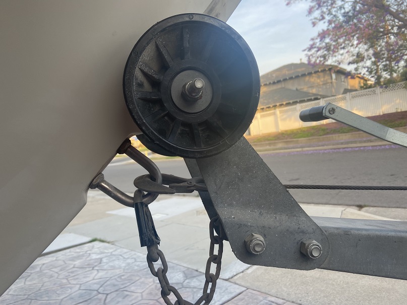

Please give me some pointers to the parts needed to convert a trailer to bunks from [floppy] rollers [for use with a REVENGE 22].
Q1: How can the boat be lifted off the trailer to change all the trailer parts?
Q2: Where can I rent a boat jack?
Q3: Where can I rent jack stands?
ASIDE: I bought a 1987 Revenge 22. Its trailer has old and deformed [floppy] rollers. I see small hull damage from a bent roller arm. This is my first boat. I didn't have any experience owning a boat at all. Bare with me.

I replaced the failing black rollers with polyurethane rollers on a floppy roller trailer for my 1988 REVENGE 20 W-T. I've had no problems.

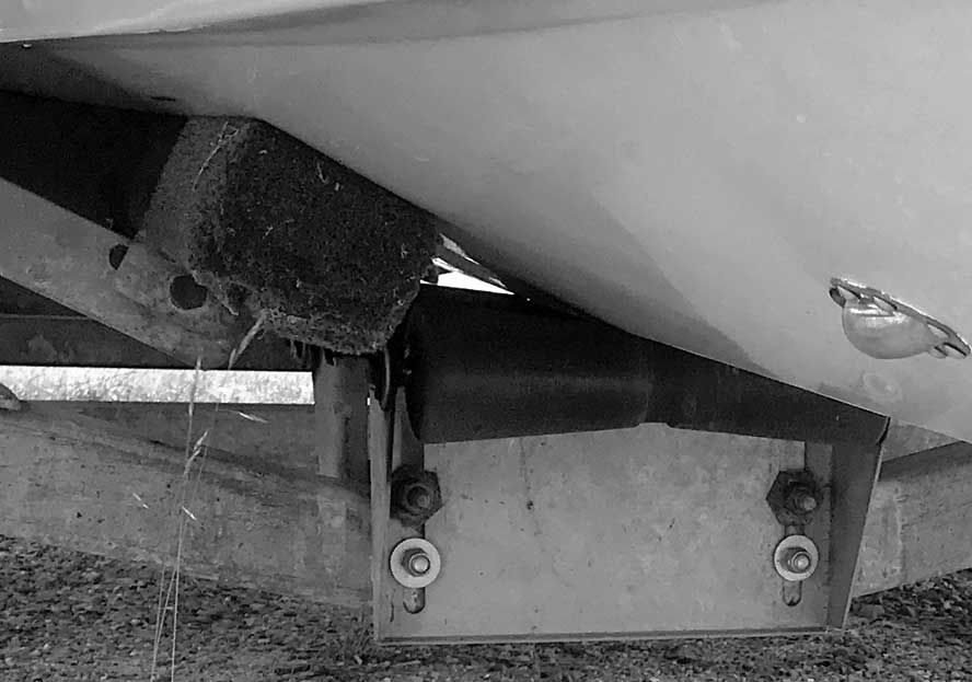

Fig. 1. View of boat hull while on trailer.
Q9: is the keel roller seen in Figure 1(partially obscured by a jagged yellow line) in the proper location?
In Figure 1 above the two red arrows point to where where I plan to install two bunks. I plan to install the bunks without lifting-up the boat, using this method:

rnln wrote:Q9: is the keel roller seen in Figure 1 (and partially obscured by a jagged yellow line) in the proper location?
Yes. All keel rollers are located exactly on keel centerline. That one appears to be held by welded-on brackets. There is no contact with the hull. The keel roller is not supporting any weight. This is typical for the aft-most keel roller. It only has contact with the hull keel at the initial point of the boat being loaded onto the submerged trailer. As the boat is hauled forward, the hull comes into contact with the bunks and other keel rollers.
Typically if the trailer has keel rollers, the inner pair of bunk boards will be located as close to center as the keel rollers permit.
rnln wrote:In Figure 1 above the two red arrows point to where where I plan to install two bunks.
The outer bunk boards would typically be farther outboard from keel center line than your plan shows.

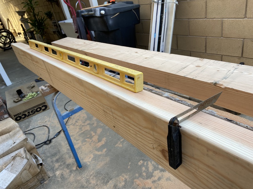

Also regarding bunks: the large flat surface of the bunk board should be able to be oriented so the entire flat surface of the bunk meets the hull, not just some small portion or a corner of the bunk board. To allow that to occur, the bunk boards are usually mounted to hinged swivel mounts so the board can articulate to meet the hull surface. Some so-called bunk or "float-on" trailers use very large nearly square timbers, and the only part of the bunk that touches the hull is the inboard upper corner. That type "bunk" is not appropriate.
Fig. 2. Detail of keel roller and inner bunk positions. The inner bunks are located just outboard of the keel roller frames.
Figure 2 illustrates the position of the inner bunk relative to the keel centerline: as close as possible and limited only by the roller brackets.
Also not that on this particular trailer the trailer frame crossmember is not straight; the crossmember is bent downward in the center. This is often seen on trailer intended for larger boats. The effect of this with regard to installing keel rollers is the often the standard brackets for the keel rollers won't have enough height to position the roller to meet the hull's keel. As seen in Figure 2, the crossmember has been drilled with two new holes for the lower bracket mounting bolts. These holes MUST be drilled on the exact centerline of the crossmember (to prevent excessive weakening of its strength). With the lower mounting hole now able to be raised several inches by the new lower hole, the keel roller bracket can be raised far enough to meet the hull's keel and support it.
Note also the paired keel rollers and their brackets. Mounting in pairs greatly simplifies mounting hardware, doubles the support, and usually has no increase in labor; of course the costs are doubled, but worth the added expense in my opinion.
When drilling the hole be sure to apply galvanizing or paint to the hole to inhibit future rust.
Also illustrated in Figure 2 is the clearance provided for the vent lid on a forward hull through-hull drain. The inner bunk boards should not be able to come in contact with this vent lid. There will also be another similar vent lid on the through-hull drain for the aft cockpit Starboard sump drain located farther outboard from the keel, and in the same manner the outer bunk boards must be positioned to not come in contact with that vent lid.

Q12: is the bunk lumber seen [in Figure 2] a 3 x 4?
Q13: is my boat sitting too high?
Q14: how much higher should the keel of the boat be compared to the top of the cross bar?
Q15: should the boat keel be 3-inches higher than the cross bar?
Q16: should the boat be 4-inches higher than the cross bar?

rnln wrote:[Is the] wood bunk...3x4?
Although the wood bunk seen in Figure 2 is from my own trailer, I have never measured its dimensions. I cannot answer your question at this time because I do not have access to the trailer. I suspect the dimension are about 3 x 4-inches.

rnln wrote:Keel roller mounting in pair, meaning each cross bar will have 1 (roller and mounting plate) in front and 1 in the back of the cross bar...
See Figure 2 again.
rnln wrote:Is my boat sitting too high now?
Figure 1 appears to show rather large vertical clearance between the boat hull and the trailer fenders, much more than suggested in my earlier remarks.
rnln wrote:How much higher should ...top of the keel roller...compare to the top of the cross bar?
This distance between the axle of the roller and the top of the crossmember is determined by the particular trailer and boat.
rnln wrote:...my boat should sit a little lower, which means it will be better..for me at the ramp
Reread my earlier comments that begin "The lower the boat is positioned on the trailer, the better in all regards..."

Q18: what kind of 2x4 wood is good for bunks?
Douglas fir was recommended to me for bunks.
Q19: is Douglas Fir lumber sold at Home Depot not great?
Q20: would Redwood be superior to Douglas Fir from Home Depot for bunks?
Q21: would rough wood be superior to Douglas Fir from Home Depot for bunks?
I think the length of each bunk is between 10-feet and 12-feet.
Q22: should I install one bracket at each end of the 10 to 12-foot long bunk?
Q23: should I install one additional bracket in [the end brackets on the 10 to 12-foot long bunk}?
Thanks again.

rnln wrote:Q18: what kind of 2x4 wood is good for bunks?
Bunks are usually not made from 2x4 lumber, so I don't have an answer if 2x4 lumber is "good for bunks."
rnln wrote:Q19: is Douglass Fir lumber sold at Home Depot not great?
I suspect the quality of the lumber available at a chain store like Home Deport will depend on the particular store. If you want prime wood, you may have to look elsewhere besides a big-box store that carries 100,000 non-lumber items.
rnln wrote:Q22: should I install one bracket at each end of the 10 to 12-foot long bunk?
The location of a supporting bracket for a bunk is generally determined by the location of the attachment point for the bracket on the trailer. The bunk may extend beyond the support for some distance, provided a lumber of suitable strength was used.
Regarding all your new questions about height of the boat keel above a cross member: please RE READ my earlier comments that begin with:
For a boat with the beam of a REVENGE 20, the critical factor in vertical positioning of the boat....
Re reading that response will allow you to understand what parameters will influence the height of the boat on the trailer. There are some interferences that cannot be worked around.

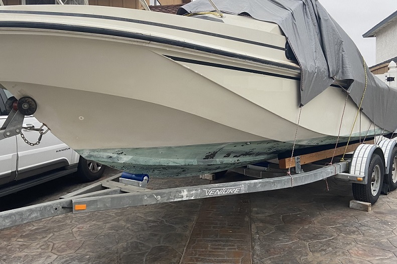

The distance the chine can lie above the fender can be as little as one-inch, as mentioned previously in this discussion.
In Figure 3 I don't see a pivot on the bunks. Without a pivot the bunk broad face cannot lay against the hull.
As mentioned previously in this discussion, sitting the hull on the sharp corner of a non-aligned bunk is a very POOR practice.
See comments above that mention "pivot bracket" and caution that "the large flat surface of the bunk board should be able to be oriented so the entire flat surface of the bunk meets the hull, not just some small portion or a corner of the bunk board."

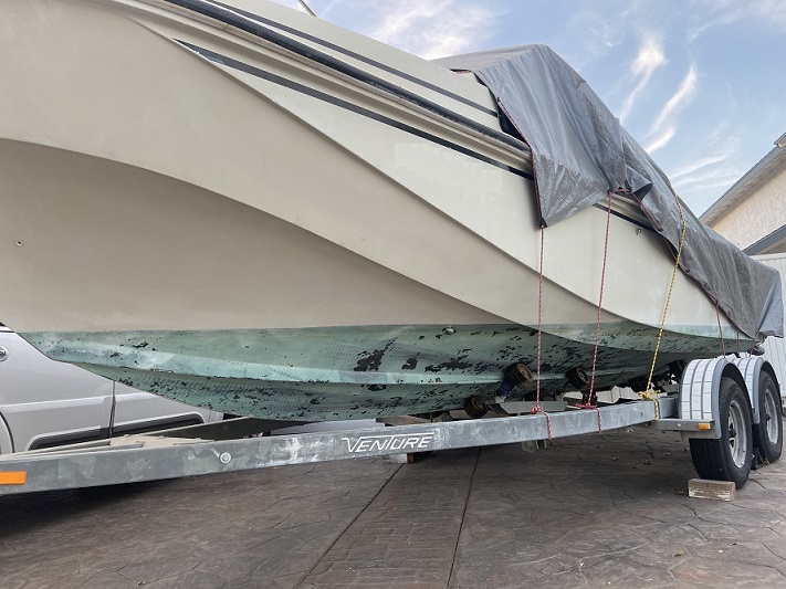

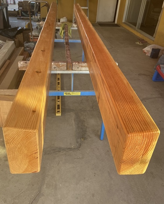

Fig. 3. Trailer originally with rollers
Fig. 4. The wood bunks are cut to an angle to meet flush with the hull.
Fig. 5. Wood given protective coating of polyurethane.

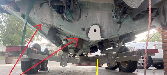

Fig. 6. The modified trailer now with wood bunks and keel rollers.
All parts are were purchased from
sturdybuiltonline.com
except the wood bunks. Thanks everyone for all information and opinions.

There is a serious problem with the winch rigging seen in Figure 6. The winch strap does NOT lead fair to the bow towing eye and is chafing on the winch stand. This is very poor rigging and should be corrected immediately before the strap wears from the chafing. If the winch and strap were original on the trailer, consider replacing the strap as there may be decay and loss of strength, particularly at the point of attachment to the hook.
After the winch stand is lowered and moved, the problem may go away. If not, the direction that the winch strap spools onto the winch drum may have to be changed so that the strap comes off the top of the winch drum to get better clearance. Again, if the winch is in its original rigging, it may not have been installed properly. Typically the winch strap pays off the drum at the top, not the bottom.
For advice on how to locate the bow stop roller relative to the boat towing eye, see the article in REFERENCE on boat trailer set up at
Trailer Rigging For Boston Whaler Boats
https://continuouswave.com/whaler/refer ... ailer.html
An illustration in that article shows the proper relationship between the bow stop roller and the boat towing eye.
Also, consider adding a hold-down strap from the bow eye to the trailer frame. This will help prevent the bow from bouncing when on the highway. Usually the winch strap is rigged so it exerts a perfectly horizontal or slightly upward pull onto the bow towing eye; having a lifting force vector on the winch strap will help pull the boat upward as it comes onto the final position at the bow stop roller or V-pad. A second strap pulling the bow towing eye downward will oppose that lifting force and stabilize the bow position on the trailer.

In Figure 6, how is the forward (blue) keel roller bracket fastened to the trailer frame?
Posts: 13398
Re: Converting Trailer to Bunks from Floppy Roller
Postby jimh » Sat May 21, 2022 11:43 am
Please show a view from astern that illustrates the position of the bunks relative to the hull runners. Show the starboard side so the aft cockpit sump drain outlet is in view.

jimh wrote:In Figure 6, how is the forward (blue) keel roller bracket fastened to the trailer frame?
By two short bolts, bolted to the holes on the frame. That little short frame has some pre-drilled holes.

jimh wrote:Please show a view from astern that illustrates the position of the bunks relative to the hull runners. Show the starboard side so the aft cockpit sump drain outlet is in view.

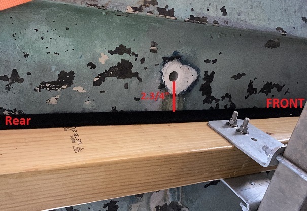

The bunk is 3-inches away from the drain sump clam shell. I will have to take pictures. I don't have any.

Postby rnln » Mon Jun 06, 2022 6:45 am
Fig. 7. The starboard bunk is 2-3/4-inches away from the through hull drain.
Fig. 8. The winch is now at the lowest possible height.
Thanks everyone,
Postby Phil T » Mon Jun 06, 2022 3:14 pm
The roller really should be kissing the bottom of the eye.
If you can't drill out the roller arms to get a better angle, then install a ratchet strap from the eye down and slight aft to the frame.
In a crash the bow will want to go up and forward.
(We just want your trailer to be perfect)

Postby rnln » Mon Jun 06, 2022 8:16 pm
PHIL--I was thinking of getting the winch low enough to have the roller to rest on the eye as you mentioned earlier, but then I realized that this is the lowest it can get. Then I remember about the option Jim mentioned, the strap. I will do the strap when it is ready to get on the road. Right now, still a long way on fixing it up.
I totally understand that you guys are trying to help. Appreciate it Phil
Thanks everyone again.

That info about the bow eye being below and touching the bow stop is [good advice].
Recently [while towing the boat on the highway] I had to do an emergency stop [for a pedestrian]. I was only doing 30-KPH an hour. When I hammered on the brakes, the trailer made a big bang noise. All was well with the boat and trailer. The boat didn't even move. The pedestrian was also unharmed.
Posts: 13398
Postby jimh » Tue Jun 07, 2022 11:15 am
Using a vertical hold down strap from the bow eye to the trailer frame will tend to prevent the bow of the boat from bouncing upward on the trailer in normal travel on the highway and the many bumps encountered on those roads.
With the distribution of weight on most boats well aft of amidships, due to the engine, batteries, fuel tanks, and other gear being more toward the transom than the bow, the weight on the bow is relatively light compared to the weight on the aft half of the boat.
With the winch strap pulling on the bow eye at perhaps a slightly upward angle, the bow may exhibit a tendency to bounce. This is the situation on my boat. The bow stop on my boat is provided by two rollers held in a frame. The bow eye is usually centered between them, and won't necessarily be jammed against the upper roller. The hold-down strap constraints vertical movement. Installation and removal of the bow strap takes just a moment. When the hold-down strap is unhooked, it remains on the trailer and hooked to the frame of the dual-roller bow stop.
For my normal launching ramp use, on the way home from the ramp (just under a one-mile trip), I have to descend a rather steep grade on my local street. There is seldom any traffic following me. I routinely make an abrupt and rapid deceleration to a stop on this downslope. This insures that the boat will shift forward if not already locked into position. When I reach home a moment later, I re-tension the winch. I don't like to leave the bow eye being pulled on by the winch with hundreds of pounds of force (for a month or more before its next use), nor do I want it too slack. I loosen and then re-tighten the winch to a moderate amount of tension.
