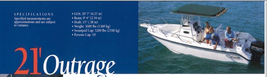

The freeboard of the 2000 Outrage 21 is significantly higher than a 15 Sport. I would estimate it to be twice as tall, about 36-inches of freeboard compared to about 15-inches15".
Fig. 1. Catalogue photo of 2000 OUTRAGE 21 boat showing cockpit and gunwales with crew aboard.
You can extrapolate the freeboard from Figure 1. Note the coaming cushion height is mid-thigh.
The post linked above is discussing the classic Outrage 18, 22, and 25 boats, which are not even closely similar in design to the post-classic 2000 21 Outrage.
