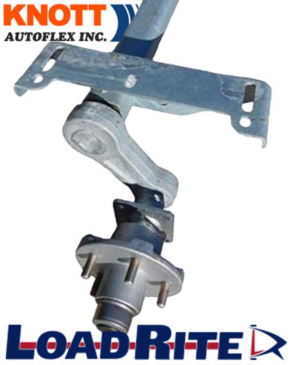

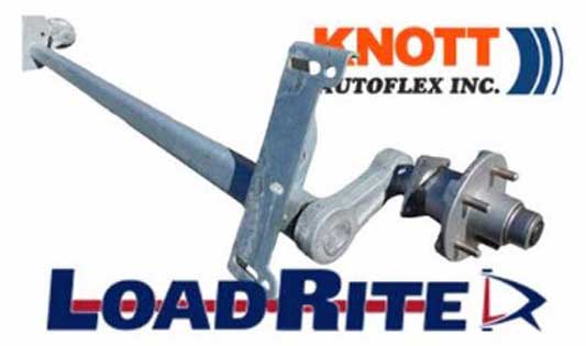

D--my box-framed trailers have a torsion-spring axle. It has a plate that is attached to the frame using U-bolts.
Isn't a torsion-spring axles sold with a plate or bracket included?
Fig. 1. Torsion-spring Axle with brackets.
Source: https://www.loadrite.com/trailer-parts/axle-assemblies-and-components/axle-assemblies-weldments-spring-torsion/1500lb-oem-torsion-axle-assembly-45-frame-centers-knott/
2.25-inch square, full, galvanized steel axle and hub assembly
with 1.06-inch diameter straight spindles
and pre-greased hubs with 5 of 4.5-inch bolt pattern
built with bearing king 1.06-incg
Price: $416.42
Wt: 70-lbs
Capacity: 1,500-lbs

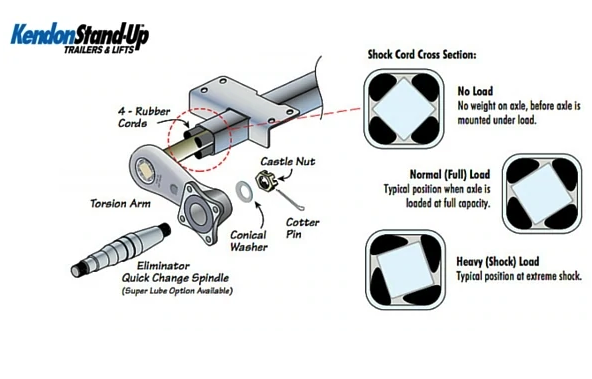

A torsen axle does not have a spring. Deflection is provided by the twisting of the axle bar inside a square sleeve lined with rubber compounds. Each wheel is independent.
Fig. 4. Torsion axle diagram.
Screen Shot 2022-01-21 at 12.13.39 PM.png (176.04 KiB) Viewed 10720 times
Source: https://www.kendonusa.com/blogs/blogs/k ... rsion-axle

Phil T wrote:A torsen axle does not have a spring. Deflection is provided by the twisting of the axle bar inside a square sleeve lined with rubber compounds. Each wheel is independent.
To tag onto what Phil posted, the rubber in the axle does a great job absorbing impact while providing wheel travel. Also having each wheel independent without a steel axle connecting each spindle is highly desired. The difference in ride is night and day.

I think the proper name for an axle that absorbs up-down wheel movement loads by twisting is a torsion axle.
There is a bit of confusion in this thread with the term TORSEN axle, which is an ingenious differential power driven axle arrangement. TORSEN is a word derived from TORque SENsing.
More on TORSEN axles: https://en.wikipedia.org/wiki/Torsen
There is also more confusion about torsion bar suspension. Torsion bar suspension uses a twistable bar fixed at one end and twisted at the other end by the individual wheel. There is no rubber involved. It was used by Chrysler cars at one time. This gave independent suspension characteristics to each wheel. More at https://en.wikipedia.org/wiki/Torsion_bar_suspension
In the system shown above, it looks like the axle is a square bar that twists against rubber cushions encased in a larger square tube.
Q5: Is the bar fixed in position in the center of the axle?
If not fixed, it would seem that the suspension of the two wheels, each one attached at opposite ends, would then interact. The torsion spring becomes one spring shared among two wheels. For example, suppose the right wheel encounters a displacement of two-inches upward. This twists the bar and loads up the rubber. Now the left wheel encounters a three-inch displacement upwards. That wheel wants to twist the bar even further. The absorption of the twisting depends on compressing of the rubber cushions. The rubber cushions cannot always exhibit a linear resistance to compression--at some point they won't be as easy to compress as they were initially when not compressed at all. At some point it will be very difficult to compress them. On that basis, the resistance to compression--this is the force that supplies the spring effect if the axle itself is not fixed in the middle--for one wheel depends on where the other wheel is. Also, consider the case if the wheels want to move in opposite directions, one up and the other down. One adds compressive force, the other removes compressive force. Who wins? It is here that I think the square axle must twist to compensate. The square axle is the torsion member, and the rubber cushions are the springs.
Actually, I think the proper name for this approach is a twist-beam suspension. Compare at https://en.wikipedia.org/wiki/Twist-beam_rear_suspension
