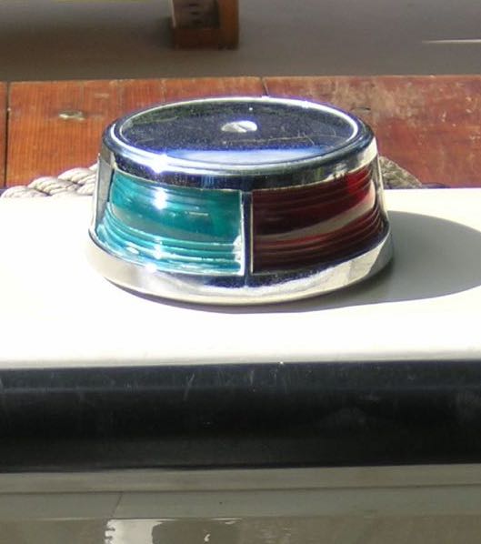

My 1976 Boston Whaler SPORT 15 used a combined red-green sidelight lamp mounted at the bow on centerline. The lamp shown below is typical of the style used in that era on the smaller boats. Boston Whaler always used a combined red-green sidelight lamp on their 13-foot to 17-foot hulls
Fig. 1. The OEM combined sidelight lamp as used by Boston Whaler in 1976 on a 15-foot hull. This lamp would also have been used on 13-foot hulls.

You can make an inference about what lamp was used on your boat from the mounting holes that remain. If the taller, heavier, lamp and chock assembly were used, then the mounting holes would tend to be for through-bolting in order to more securely mount the lamp base to the hull so that it could withstand the stain of the the mooring lines running through the chock.
The the smaller lamp-only style combined sidelight lamp were used, the mounting holes would be smaller as smaller self-tapping screws would have been used, not through-bolting.
