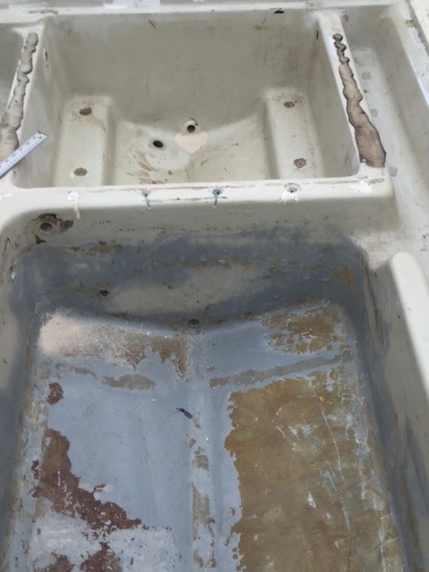

The bulkhead between the fuel tank cavity and the rear fish box will have to be cut out. The cut out area will need reinforcement with fiberglass.
Figures 1, 2, and 3 shown my 1980 Revenge 22 without the foam around the tank being replaced. Your hull liner should be the same as the Revenge 22. A 122-gallon fuel tank will be extremely heavy when full so I believe you will want to reinstall the foam around a 122-gallon new tank for added strength.
Fig. 1. Fuel tank cavity empty.
Whaler Pic fuel tank and bait tank cavity empty shot from bow side.jpg (64.17 KiB) Viewed 1959 times
