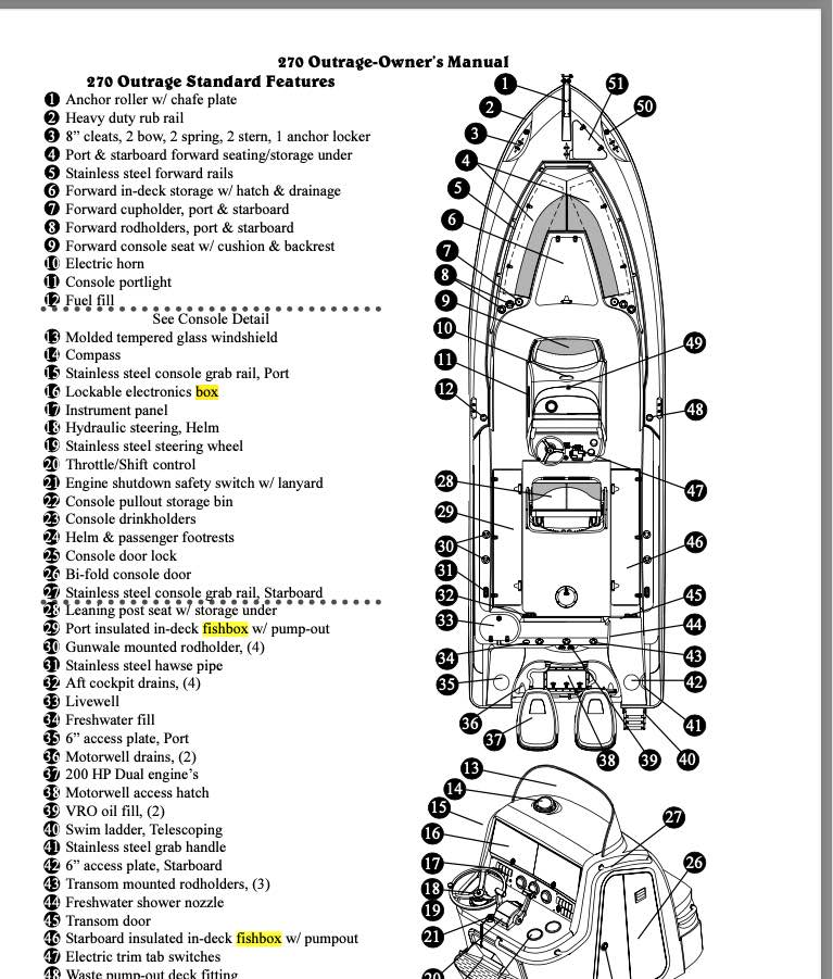

Fig. 1. Layout of the 270 OUTRAGE identifying major components
There is no "forward fish box". Are you referring the port side midship fishbox or the forward in-deck storage?
See page 4 of the manual.
Which item on that drawing are you referring to?

A quick search of the owner's manual (as linked above) does not find the term "macerator." With that outcome, I don't understand the basis by which the pump in the "forward fish box" is being described as a "macerator" pump.
Re the absence of a compartment on the boat that Boston Whaler refers to as the "forward fish box": the helm electrical panel has a switch with label "FWD FISH BOX." Also, a diagram on page 11 of 44 (of the PDF version of the manual) shows a simpler callout detail that identifies callout 4 as the "Forward Fish Box." On that basis, I believe there is a good reason to describe the sump compartment in the center of the foredeck as a "forward fish box." Contrarily, this same item is identified in a different drawing (the illustration partially reproduced above) at callout 6 as the "forward in-deck storage." The authors of the operator's manual seem to have used two DIFFERENT names for the the same object.

It is item number 6 from the standard features in the owners manual referred to as "Forward in-deck storage."

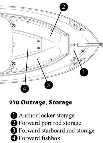

Fig. 2. Excerpt from illustration "Storage Compartments" with Callout 4 indicated as "Forward fishbox."
The below deck compartment of the foredeck of the boat is identified in the illustration on the page numbered "9" (page 11 of 44 in the PDF document) Section 2--General Arrangement and Specifications with Callout 4 as "Forward fishbox." See Figure 2 above.
As I mentioned already, the same compartment is identified twice, with different names.

Jim, look at line item number 6 on the Outrage Owners Manual that was provided to the forum by Pill T. It is on page four of the manual. I referred to it as a fish box. The proper name is forward in-deck storage. Underneath that "forward in-deck storage" compartment. are two through hull drains and a center "Fish Box" pump out. Yes Boston Whaler calls it a Fish-Box pump out (see item 9 on drawing number PB270OR2.) Now, one of those through hull drains, in the "forward in-deck storage," or the "fishbox pump out" must be leaking into the bilge. My plan is to fill that forward in-deck storage full of water and try to see from below it, (the forward in-deck storage) to see if any of the above drains (which must be obvious to the readers by now) are leaking into the bilge.
