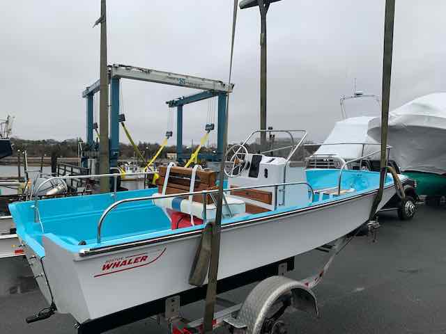

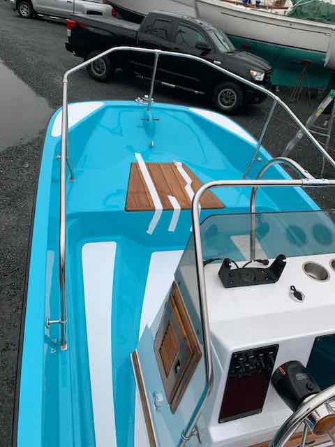

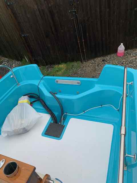

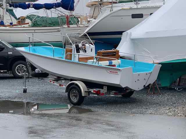

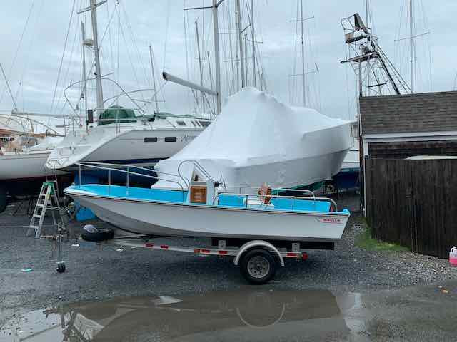

I was lucky enough to find pretty much exactly what I was looking for: a restored 1985 Montauk 17 without an engine.
Fig. 1.
Fig. 2.
Fig. 3.
Fig. 4.
Fig. 5.
Fig. 6.
Fig. 7.
Fig. 8.

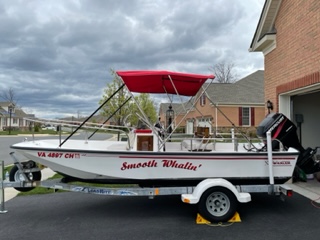

Additionally, I really think it will need a Bimini too but I don’t love the ones that lie flat in the bow. Any ideas on ones that store in the “up” position and look more like arches?
I am currently installing a Carver stainless steel frame Bimini on my Montauk 17. I purchased the stainless steel support kit which consists of the two supports and fittings to allow the top to be stored upright. Also available are stainless removable pins for the supports which allow the top to be lowered for winter storage under a cover or wrap or whenever one wants to lower the booted cover completely.

The boat looks great, and--while a departure from original--I can appreciate your changes.
While the rub rail and color are different, I would have positioned the Whaler logo in the position is came from Whaler; that is probably the biggest eye-catching detail that says the boat isn't original.
I did a restoration on my 1986 Boston Whaler and changed many things, but made sure to apply the decal in the original position.

Good eyes. The logo seems to be both too small and too far back.
Full disclosure: I had nothing to do with any of the modifications, colors, or rub rail choices. I just luckily stumbled upon the boat for sale the way it is.
The boat just got up to Massachusetts last Friday, and before that I had only seen it in pictures and for about 20 minutes when I bought it.
I am trying to figure out changing the logo and how much effort that entails.
Also the hull needs rear towing eyes and a white all-round lamp. There is plenty to think about before it goes in the water.

The two-tone blue-white color scheme reminds me of a c.1955 Chevrolet car. They offered several two-tone paint schemes back then.

[The two-tone blue-white color scheme is] certainly not a look I had ever seen before on a Whaler. The scheme has really grown on me, especially in person. When it got up to Massachusetts, the guys at the boat lift and marina where there are a lot of old Montauks, didn’t really mention the colors; they only said that it looked like it just came from the Rockland factory up the road.
MORE BACKSTORY: I had been trying to find a restored ribside, but my kids and wife all hated the look of those boats, saying a ribside looked like “something that was used at D-day”. Then when I stumbled on this boat I first saw pics and was like “ehhh I don’t know”, but my kids and wife really liked it as I guess they are not Boston Whaler purists.

The reversible pilot seat seen above in Figure 8 looks great. The seat cushions with the blue piping and the blue center section continue the blue-white theme of the deck and interior color scheme.
The overall condition of the boat looks excellent--a ten. Now your task will be maintaining it at that very high level of appearance.

Snowboard wrote:What are the dimensioned of the Carver Bimini you are using?
I ordered my top by boat model and year, through Boat Covers Direct. I did not order with specific measurements. For some reason I do not see the stainless option on their website, but last September it was there. Each stainless top is manufactured to order.
I have put the top together, but I am waiting for better weather and help from family to complete the installation. The top is awkward to handle by myself and I want to make sure I locate the fittings correctly. I will post pictures once completed.
Because I was bored and decided to take some measurements this morning to prep for the installation, I measured the space between the mount fittings of the top and that measured exactly 66-inches, almost exactly the spread between the port and starboard gunwales. That space between the gunwales measured 67-inches. The frame can spread slightly so the fit looks fine.
I will measure again once installed and give you those numbers if you need them. It may be a week or two before I get the top on the boat.
