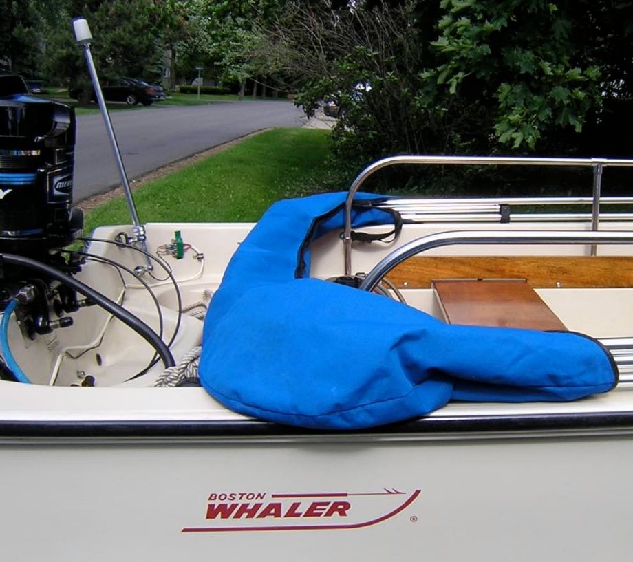

Figure 1 below shows the position of the WHALER logo on my 1976 SPORT 15 boat. To the best of my knowledge, decal is original decal and in the original position.
Fig. 1. The location of the WHALER logo on a 1976 SPORT 15 boat. The distance to the stern can be inferred from the position of the seat and railings.
