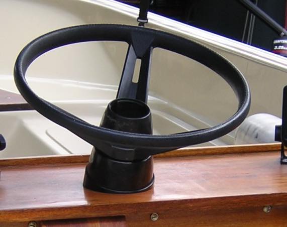

JHBSport wrote:Q2: was 1970 a transition year for the steering wheels?
I do not think that 1970 was the year in which Boston Whaler began to use only stainless steel five-spoke or six-spoke steering wheels as the standard equipment on their small boats instead of plastic steering wheels.
I bought a 1976 SPORT 15 and it had the OEM steering wheel. The steering wheel was NOT a stainless steel steering wheel. See below in Figure 1.
Fig. 1. The OEM steering wheel on a 1976 SPORT 15.
I cannot imagine that in 1976, six years after your proposed start of the epoch for the introduction of stainless steel steering wheels on 13-foot Boston Whaler boats, that Boston Whaler would be selling a 15-foot boat without a stainless steel steering wheel as standard equipment, but selling 13-foot boat with them as standard equipment. That makes no sense.
