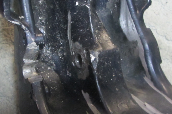

The power trim and tilt was not working. When removing the trim and tilt assembly from the engine swivel bracket I saw that someone had tried unsuccessfully to drill out the upper pivot pin. They also managed to break off a part of the bracket opposite the pivot pin. I soon realized that the pin was corroded solidly to the swivel bracket and was not budging. That explained the damage from someone trying to get it out.
The lower tilt shaft came off easily. The upper pin had to be cut off with a cut-off disc on an angle grinder.
Damaged swivel bracket. Note last bit of pivot pin remains.

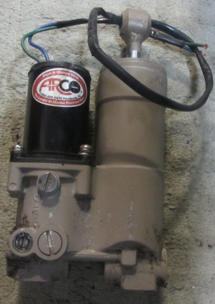

With the trim and tilt assembly free, I investigated why the power trim and tilt assembly did not work.
First step in any analysis of a hydraulically operated device: check the hydraulic fluid level. I opened the filler hole and foamy fluid spat out. That indicated air was mixed with the hydraulic fluid. The fluid reservoir was drained. New Dexron hydraulic fluid was added to the reservoir.
The hydraulic pump motor was tested by connecting it to a battery. A loud screeching noise was made, but the ram did move a bit. Repeatedly applying battery power to the pump motor in short bursts eventually resulted in the ram moving up and down--in fits.
After letting the unit rest and the letting the air expel from the oil, more hydraulic fluid was added to the reservoir to reach the fill line. With each addition of more hydraulic fluid, the unit worked better.
Eventually I was able to operate the ram through five full-up to full-down cycles, as the factory service manual recommended.
Next, with the ram in the up position, the level of the hydraulic fluid is checked. More fluid was needed to bring the reservoir to the full mark. Then the trim and tilt assembly began to work very well.
The pump motor looks new; I think someone replaced it, but did not follow the instructions to correctly fill the reservoir with hydraulic fluid.
Trim and Tilt unit. Topmost screw beneath motor is to check the oil level.

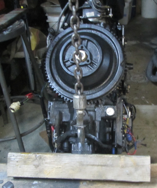

For safety sake I bolted a 1-foot-long 2 x 3 to the thermostat housing. Even though I had the outboard engine suspended from a hoist, I needed to keep it from tilting sideways while working.
Wood 2x3 bolted to motor for stability.

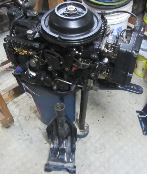

First, I removed the mounting bracket from the engine.
Then I removed the lower exhaust housing clamps to free the swivel bracket. The steering arm is mounted in rubber biscuits and has some give. I started to bend the bracket and the steering arm away from the exhaust housing. I slowly bent it away, more and more, while jamming a piece of wood between the housing and the bracket. Care must be used to not to let the steering arm hit the lower carburetor. The arm will bend to the side a bit and clear the carburetor.
Once the bottom of the steering tube is clear of the exhaust housing, the swivel bracket can be tapped down and off the steering arm.
Clean the steering arm and all the parts before installing the new swivel bracket.
Swivel bracket removed from steering arm with powerhead still in place.

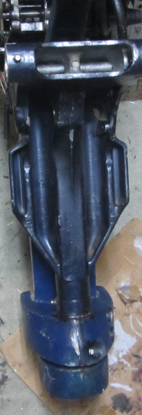

After cleaning the parts swivel bracket I attempted to install it on the steering tube. I again pried the steering tube away from the exhaust housing until the swivel bracket could be loaded onto the steering tube. Here I found a problem. The manual states to load all the shims, seals, and bushings onto the bracket before sliding the steering tube into it. That may work with the powerhead off but not this way. The problem is that at the very bottom of the steering tube the diameter is slightly larger than the upper portion. That makes it a very close fit for the parts and impossible to get the bracket on with them in place. I loaded the shims and seals that belong at the top of the bracket first. Then I slipped the bracket onto the steering tube. There is a lip inside the bracket that wants to catch and stop the tube. By inserting a long pry bar inside the hollow tube I pulled the tube away from the bracket and then it went past the lip. At the very bottom of the bracket is a plastic washer. It went onto the bracket easily but was a very tight fit on the tube. I slowly tapped it up the tube with a 1.5" spanner and a hammer but then it stopped. I don't know why because it was from this same motor. I ended up breaking the washer and using the washer from the damaged bracket. That one went on easily. Once the swivel bracket was in place I could then replace the exhaust housing side clamps to retain the bracket. Here is the replaced bracket ready for the mounting bracket to be re-installed.
Replaced swivel bracket.

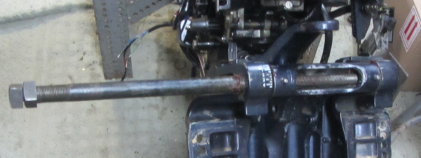

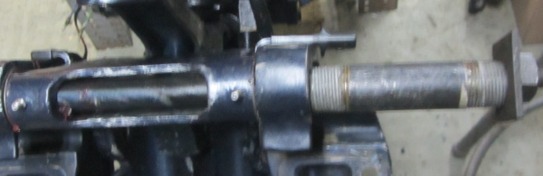

Today I mounted the motor mount bracket to the swivel bracket. Forget the big hammer. Use a length of threaded rod, nuts, big washers, and some short spacer pipes so you can press the tilt tube into the brackets smoothly and carefully. Clean and lube the plastic washers and tilt tube with Triple Guard Grease. Insert washers into the depressions on the ends of swivel bracket. Line up the mount bracket to the swivel bracket and insert the threaded rod with the tilt tube slid over it.
Threaded rod about to press tilt tube in.

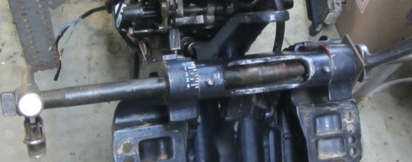

Press the tilt tube in slowly and stop if it gets hung up. It should go in cleanly so don't force it. Initially the threaded rod will pull most of the tilt tube into the brackets.
Tilt tube half way in.
At some point you will run out of play and need to use a section of pipe larger than the tilt tube for it to slide into.
Pipe sleeve lets the tilt tube be pressed inside.

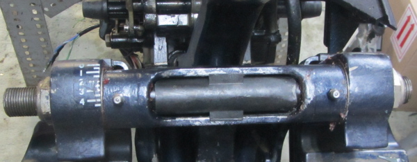

Continue drawing the tilt tube into the brackets until it is positioned correctly. You need enough threads to screw the tilt tube keeper nuts on but more on the starboard side for the steering cable nut to fit all the way. Torque the tilt tube nuts to 40-45 ft lbs then back off 1/4 turn. I felt that was too loose and sloppy so I hand tightened the nuts so there was just a bit of drag on the tilt tube.

When the tilt tube is installed correctly there are enough threads on the starboard side to screw the steering cable nut on. If your steering cable is on the port side then leave enough threads on that side. The instructions on the steering cable nut say to screw it on completely and make it tight. If done correctly the steering cable nut will be on all the way and there will be a few threads left between the steering cable nut and the tilt tube nut.
Note the longer threads on the starboard side of the tilt tube.
