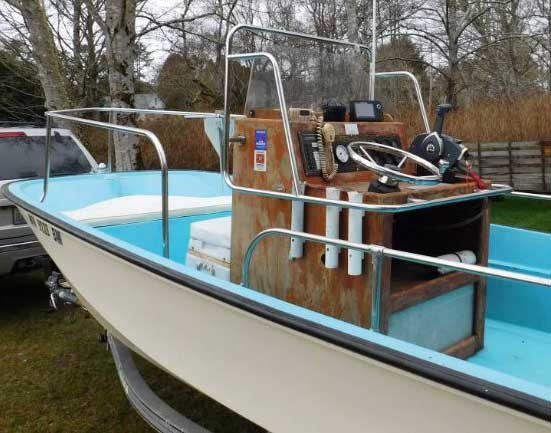

In Figure 1 there should be a hull stencil number visible on the inboard face of the transom in the center, but none is seen. Perhaps the hull stencil number was painted over. If the boat is a 1971, the hull may not have a federal hull identification number. Those were not required until 1972. For more advice about identification of the year of production, consult the FREQUENTLY ASKED QUESTIONS article at

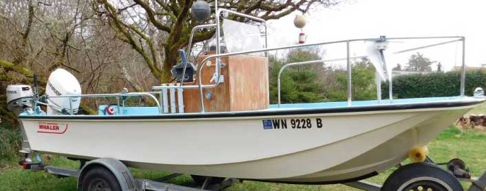

The hull as seen in Figure 3 is clearly the older 16-foot hull, without the smirk, definitely pre c.1976.

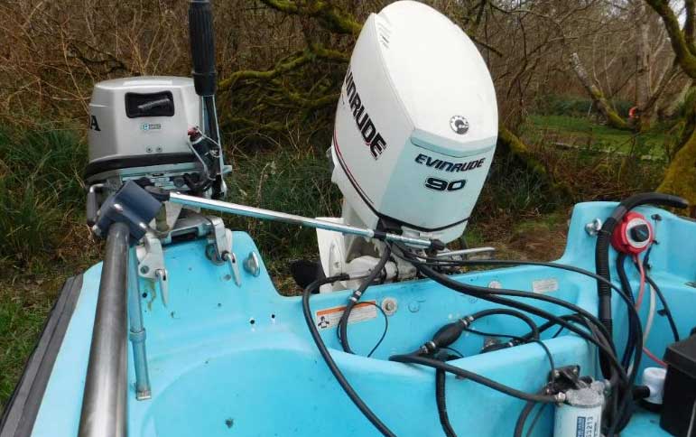

The console as seen in Figure 2 is very unusual. I doubt it was an OEM product from Boston Whaler.

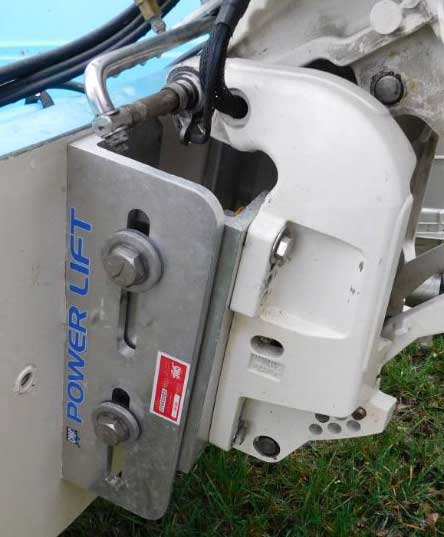

Figure 4 shows a set-back bracket with power lift adjustment. Some boaters are fascinated with adjusting engine mounting height while underway and employ such devices.

A Boston Whaler hull with a non-factory interior is referred to as a custom. For the 16'7 hull you would label it as:
16' Custom
Based on the limited information shown in the photos, you are looking at 3-6K. Depending on actual condition and age of engines.
