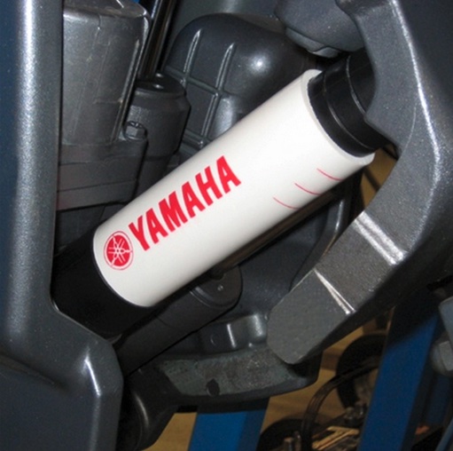

Yamaha offers tilt trailer supports.
E.G.https://www.simyamaha.com/engine-tilt-trailering-support-mar-mtspt-ym-10/
Fig. 1. Yamaha engine with "transom saver."

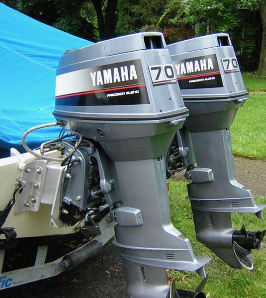

Regarding an engine position appropriate when the boat is loaded on a trailer and will be towed on the highway, Figure 2 below shows how I positioned the twin Yamaha 70-HP engines on my boat during about 20,000-miles of highway towing. No "transom savers" were ever used, nor were they ever considered to be needed. The engines were position so they were restrained in downward movement at the top of the dual actuator rams of the slow-speed trim actuators, and restrained in upward movement by gravity and the single high-speed ram actuator.

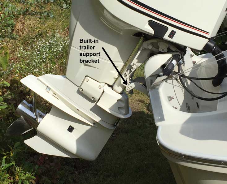

Evinrude E-TEC engines have a built-in trailer support bracket. I always use that bracket when towing my boat with E-TEC 225-HP engine.
Fig. 3. 2010 E-TEC 225-HP engine with built-in support bracket for trailer towing.
We have towed the E-TEC in the position provided by the built-in trailer support for probably more than 20,000-miles and hundreds of hours. For example, we towed to Wisconsin and the Apostle Islands in 2012, which meant four days on the road.
