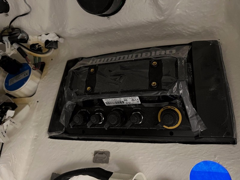

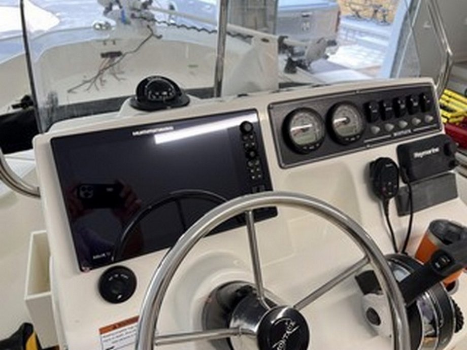

rdewers
Posts: 7
Joined: Fri Feb 25, 2022 2:40 pm
Re: 2022 190 MONTAUK: SONAR Display Location
Postby rdewers » Sun Mar 24, 2024 11:50 am
I apologize for replying a couple of years late. Many thanks to all of you for your advice.
I ended up installing a Humminbird Solix 12. It fit very nicely, but it is about the biggest display that will fit. If I ever decide to upgrade I will likely have to cover the hole with a plate and surface mount a larger display.
Fig.1.
2022-05-19 10.29.46.jpg (93.92 KiB) Viewed 3881 times
Fig. 2.
2022-05-19 11.52.53.jpg (91.33 KiB) Viewed 3881 times
