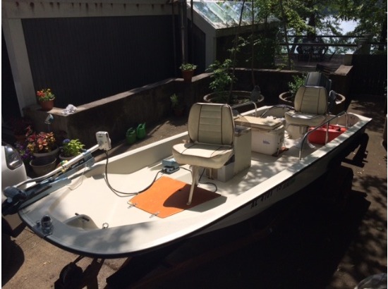

Fig. 1. Photograph used in For-sale listing for a boat described as a 1984 STRIPER 15.
See https://www.smartmarineguide.com/L49615163
