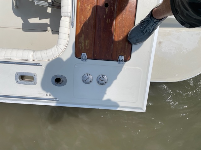

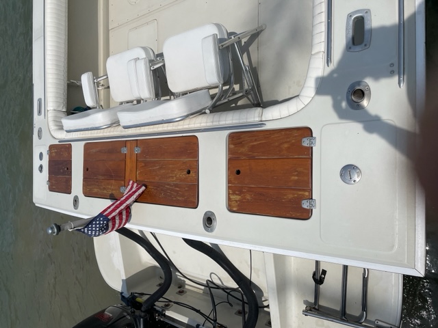

On a 1987 WHALER 27 (that I just inherited) there are two [fuel filler inlets] on the aft port gunwale. On the aft starboard gunwale there is a single fuel filler inlet. The two aft-most fuel fill inlets are aligned in their fore-and-aft position on the gunwales. See illustrations Figure 1 and Figure 2 below.
Fig. 1. Aft gunwales showing three fuel fillers,
Fig. 2. Port aft gunwale showing two fuel fills.
I have been told that the port forward fuel fill is for the Center or Main fuel tank. The port aft fuel fuel fill is for a Port Saddle Tank.
The fuel gauge for the Center or Main fuel tank and the fuel gauge for the Port Saddle Tank do not work.
Give me guidance [about which fuel filler inlet on Port is connect to which tank].
[Moderator's note: apparently readers are to infer that the fuel filler on starboard aft gunwale is for a Starboard Saddle Tank. Perhaps the OP can clarify that inference.]

To clarify, the starboard fuel filler is for the starboard saddle tank.

Once you have the fuel tank level gauges working, you can easily deduce which fuel fill inlet on the Port gunwale is associated with which fuel tank by observing which tank level rises with added fuel.
Are the fuel tank level gauges using a mechanical indicator of fuel tank level directly or magnetically coupled to a mechanical tank float arm?
Or are the fuel tank level gauges using an electrically linked indicator coupled to a mechanism in each tank that gives a variable resistance that is proportional to tank level?
Not discussed so far is the fuel distribution system. If there are three fuel tanks I would expect there must be a fuel manifold with valves that controls fuel flow of each of the three tanks to each of the two engines in some undescribed manner. If those valves are not clearly labeled, then you will soon need to deduce which fuel tanks are associated with which valves. Having fuel tank level gauges will also be useful in that deduction.
In the meanwhile, your inference (and the advice others have already given you) that the two fuel filler inlets that are aligned in their fore-and-aft location on the two gunwales are probably for the saddle tanks sounds like a reasonable inference. I would not expect Boston Whaler to have done it any other way. This leaves the MAIN or CENTER tank to be the third filler, the one on Port that is more forward.

Thanks for your confirmation regarding my inference concerning the aligned fuel filler inlets as well as the Main tank filler on the port side. All the pictures (with three Fuel fillers) I have looked at have had two fillers on the port and one on the starboard.

For what its worth, through process of elimination after the Port Saddle tank ran out of fuel. We were able to determine the Forward fuel Fill (offset Fill) is for the Port Saddle tank. The aft Fuel fill is for the Main Tank.
