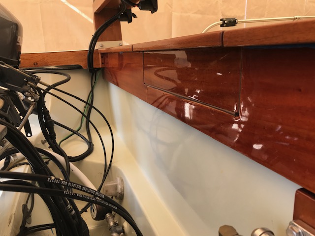

Whaler Pic stern bulkhead starboard to port transome side 4-6-21.JPG (105.36 KiB) Viewed 2640 times
In this picture are the two different finishes. The mohagany on the side of the wall is the oil based varnish. The top cap is 6 coats of Totalboat Halcyon. The difference is more prevalent in the picture than when you look at it in normal daylight.
