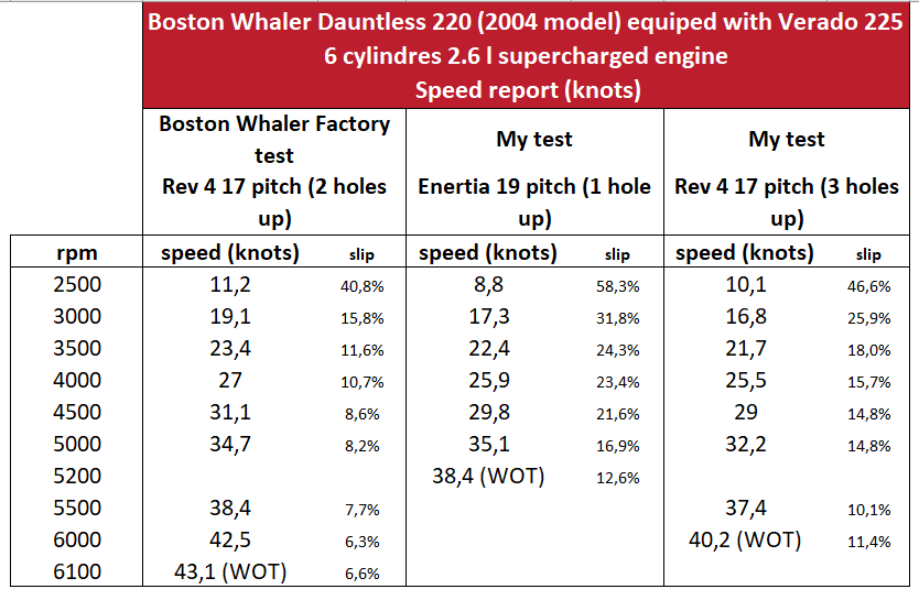

I did a first test, but need to go more into details as family was on board with me and we had just little time to spend on the water.
4 adults + 1 dog on board (less than 550 lbs)
I would estimate 100 lbs of anchor, safety gear, and other stuff
No wind - the ocean looked like a lake
Outside temperature : 28° celsius
I just recorded the top speed I could reach : 38,1 knots @ 5200 rpm, fully trimmed up.
And I also reported a 20 knots @ 3000 rpm (very comfortable ride at that speed)

Postby Lupi » Wed Aug 03, 2022 5:54 am
We went for a ride yesterday.
Weights
Four adults and a dog: about 550 lbs
Stuff: about 100-lbs
Gas : 200 litres or 52 gallons
Water about 30 litres 8-gallons)
Weather
Small chops
Wind 5 knots
Sunny
Engine
VERADO 225
Engine height: one-hole-up
[Gear ratio--very important parameter--1.85]
Maximum recommend engine speed 5800 to 6400-RPM
Propeller [three-blade stainless steel] ENERTIA 14 x 19-putch
DATA
SPEEDS
ENGINE BOAT
RPM Nautical Miles Per Hour
1500 5.6
2000 6.8
2500 8.8
3000 17.3
3500 22.4
4000 25.9
4500 29.8
5000 35.1
5200 38.4 (Wide Open Throttle)
Re: 2004 220 DAUNTLESS VERADO 225 Propeller
Postby jimh » Wed Aug 03, 2022 11:57 am
Thanks for the follow up report on the engine and boat speed data you observed on your latest test run.
Using the continuousWave.com PROPELLER CALCULATOR for speeds in nautical miles per hour and your data for the WOT test, the propeller SLIP calculates to 12.6. This is a reasonable value.
The SLIP value can be affected by how the engine trim is set. With higher engine trim the SLIP will increase as the propeller begins to operate in water with aeration.
In my experience with Mercury three-bladed propellers like the MIRAGEplus, a value of 12.6 for SLIP is reasonable. Because I have not tested an ENERTIA propeller, I don't know if the ENERTIA would typically have a lower SLIP number.
To get a comparison, I found a performance report from Boston Whaler for another boat (190 OUTRAGE) using an ENERTIA 19 pitch. In that report the engine gear ratio was different. But it can still be useful. I took your boat speed, 38.4-NMPH, looked for data in the other report at that boat speed. The closest speed was 37.3-NMPH. Then I computed the SLIP of the ENERTIA 19 with that boat's engine speed and gear ratio. The result was the ENERTIA 19 propeller slip was 8.4.
What I am demonstrating is that in one test by by Boston Whaler using an ENERTIA 19 at a boat speed 37.3-NMPH the propeller slip was 8.4 and the second test with your boat using an ENERTIA 19 the propeller SLIP was 12.6.
The difference is likely due to the fact that the other boat was a smaller and lighter boat than yours, so it would be more easily propelled than your larger and heavier boat. That explains why the lighter boat at about the same boat speed with the same ENERTIA 19 propeller was exhibiting a lower SLIP value.
The test weight of the 190 OUTRAGE was specified at 3,060-lbs at the time of testing.
The weight of an empty 220 DAUNTLESS with no engine is 2,580-lbs; add about 700-lbs for the VERADO and a battery or two, 400-lbs for fuel and water, 700-lbs for crew and gear, and I expect your boat weight during testing was about 4,380-lbs, so significantly heavier than the 190 OUTRAGE at 3,060 for its test.

I think I have figured out the reason for the poor performance.
In 2007, the last year the Dauntless 220 was produced, it was offered with the optional Verado 225. With that engine, the factory supplied the Mercury Revolution 4 prop in 14-5/8 by 17.
Note the factory did significant testing to the selection the appropriate prop for the boat/engine combination.
For many reasons I will not bore you with, I suggest you replace the existing prop with the Rev 4 in the size above. It is clear the prop model and size you currently have is not appropriate.
Keep in mind, the boat is propped so it reaches the top of the RPM limit with satisfactory speed. This is not necessarily because you need to go this fast, it ensures the engine operates efficiently at any speed.
cf: https://www.bostonwhaler.com/content/dam/boston-whaler/technical/resources/220-Dauntless-Engine-Installation-2007.pdf

I experienced the boat during August and this is really a fantastic boat with a lot of space for the family and versatile enough for fishing as well. Engine is running well and is very quiet. This combo is perfect.
Regarding the propeller, I used the trim up to 10 (maximum allowed when running) and the rpm jumped to 5800 at WOT, but with no improvement in the top speed that remained between 38 and 39 knots.
Based on your good recommendations, I will chase for a revolution 4 prop with a pitch of 17 inches. I will look at the second hand market because of the price, and I will resale my Enertia 19 pitch. In addition, I will put the engine 2 holes up (as per the diagram from Boston Whaler). This should give some additionnal rpm. I was wondering if Mirage plus or Tempest SS propellers would work well, or even Enertia with a decreased pitch.
I understand from Phil 's answer that Boston Whaler did significant testings before they conclued on the Revolution 4, but wanted to know if other SS propellers they tested were not so far in term of global performances.
The reason why I'm asking this is because we do not have so many offers on the second hand market in France and it may be difficult to find a specific model.

Hello,One year later.
I finally could purchase a Revolution4 propeller at a good price. It is in good shape and I asked my mechanic to replace the old Enertia 19 pitch with that Revolution.
I asked also my mechanic to raise the engine two more holes. The engine is currently at three-holes-up from lowest mounting height, that is one more hole than the Boston Whaler recommendation (as per the diagram Phil shared in the post above).
I went out to test this new configuration. The boat was lightly loaded with :
- three adults
- 20-gallons fuel
- Gears for fishing (mainly rods and lures)
- Bimini (that was down for the speed test)
- Other gears (anchor, sunpad, security life jackets etc...)
- Bottom paint
Engine : Verado supercharged 225 hp L6 with gear ratio 1.85
Weather : calm, very small chops
See attached the results in a chart in which I have added the Boston Whaler factory test figures as well as the data reported last year with the Enertia propeller.
Fig. 1. Table of boat speed data with various configurations.
Dauntless 220 data report.png (36.18 KiB) Viewed 38537 times
At a first glance, the performance is much better with the Revolution4 propeller, but still far from the factory testing. I guess, it may be nearly impossible to reach same performances as BW did. Feel free to comment.
Postby Phil T » Fri Aug 11, 2023 2:54 pm
If you look at the factory test, the weather is typically tropical, no wind, no current, no waves, very little fuel, no water, no gear or equipment. One person and no bottom paint.
Q5: Are you running premium fuel?
The bottom paint and fuel can easily explain the difference.
That engine hour report is disconcerting. Try to run your engine at wide open throttle (WOT) for at least 10 minutes every time you go out.
Postby jimh » Fri Aug 11, 2023 5:05 pm
I hope you used my Propeller Calculator to compute all those SLIP values:
https://continuouswave.com/calculators/ ... cKnots.php
Lupi
Posts: 38
Joined: Mon Aug 28, 2017 4:28 am
Postby Lupi » Mon Aug 21, 2023 4:46 am
Those slip values come from an Excel spreadsheet I've built, but have been compared with the slip calculator and they perfectly match, one by one.
I'm not sure the fuel used is premium fuel. It comes from gas pump of the marina and I have no idea of its quality.
I understand Boston Whaler test run are performed under ideal conditions that are difficult or impossible to reproduce (fuel, bimini, gears, people, dog, bottom paint etc...). I am happy with the current performances using the Revolution4 propeller.
Regarding the engine hour report, it has been edited just after I purchase the boat last year, so it belongs to the previous owner of the boat who used the Enertia with a pitch of 19. So I am not surprised the engine did not reach more than 5200-RPM.
