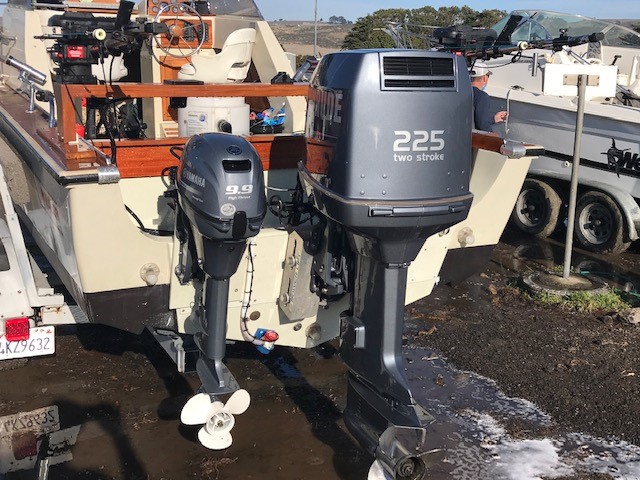

My 1980 Revenge 22 had a black ball scupper at both the transom drain and the transom side of the tube between the below deck fish well and deep motor well. They were original from the factory but no longer available so I replaced the one on my transom with a T-H Marine Flow Max Ball Scupper. There wasn't enough room to replace the factory ball scupper inside the deep well transom so I now use a plug inside my below deck fish well to keep it from flooding with water from the motor well. From what I can tell from your pictures the T-H Marine or similar Ball Scupper was used and your pictures only show the base plate.
The transom on the 22 Revenge and Outrage hull's are very low and water easily washes over the transom into the deep motor well. If there is not a ball scupper in the transom drain there is no way for the water to escape the motor well unless you were to install a bilge pump. Apparently the factory chose the ball scupper as a check valve to allow the deep motor well to drain.
Due to additional drainage I have installed. I now have 6 of the T-H Marine Ball Scuppers on my Revenge 22 which are going on their 4th season and drain extremely well while the boat is on plane, and allow very little water intrusion while the boat is not on plane.
Here is a link to one on Amazon: [bad link removed--please give a better URL]
Here is a picture of my 1980 Revenge 22 that shows the T-H Marine ball scuppers
Whaler pic full transom both motors and scuppers.jpg (121.73 KiB) Viewed 5765 times

The pictured doesn't show it but I usually have 4 Scotty electric downriggers with 60" booms mounted on the Mahogany downrigger beam across the stern wall which I made even with the factory lip on the rear deep motor well. The downriggers and Mahogany beam were not figured in my weight equation because they were not mounted on the stern. I have two group 31 batteries on the Starboard side. One under the shelf beside the helm seat just behind the starboard inspection cover and the other in the helm under the cabinet.
On the port side cabinet I have a small group 22 battery that starts/operates the Yamaha T9.9 and the two port side down riggers.
With all of this weight listed above, myself and two others, along with gear and a fairly small ice chest for drinks and lunch my drain sump with the plug removed fills to just under the floor level.
As to the original topic of this thread.
Using my experience on the water. I'm very aggressive when it comes to fishing. I don't have the luxury of picking the best days for ocean conditions so I often fish on lousy water. On several occasions while reversing into swell and wind chop to hold my position and slow my drift with the weight described above and anglers at the stern; my deep motor well has filled completely to the top with water.
The factory deep motor well needs to be able to drain and the ball scupper system works terrifically. When water doesn't come over the stern there is very little water that enters past the ball scupper. That little ball in the scupper really seals well. In fact, I don't know if I have ever seen more than an inch or two of water in there while at anchor.
