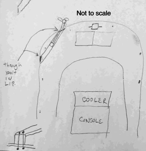

Postby Phil T » Mon Jun 27, 2022 3:21 pm
The forward cap of the Outrage 19 and the anchor locker doors are going to make installing a trolling motor more difficult than on most models.
While you can add a hinge to the rail, it may be necessary to have a complex mounting assembly that spans the curve of the bow and long fasteners to allow you to through-bolt.
A shelf with vertical risers cut at an angle and a flat plank where the motor is secured may work The risers will have holes drilled to allow long bolts to fasten through the lip with shaped washers.
Here is a rough drawing to show the concept.
Sketch showing location of trolling motor.
There are slides available for some motors that you can add risers to.
