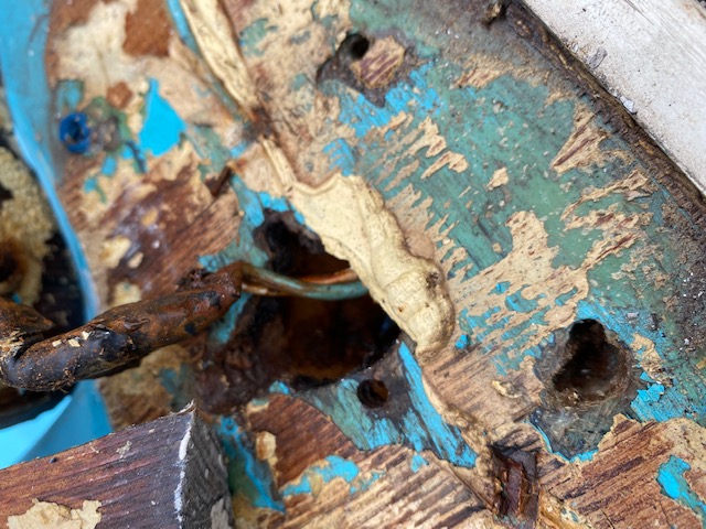

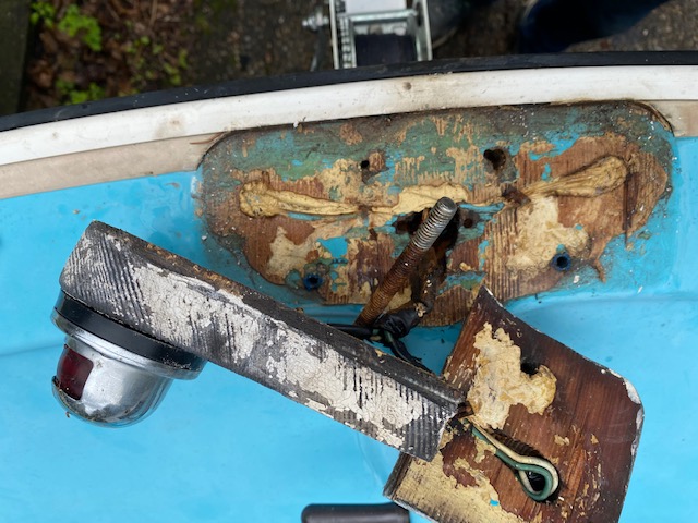

The previous owner of my 1972 SPORT 13 reconfigured combined sidelights navigation lamp at the bow.
Fig. 1. Non OEM lamp
Bow 1.jpg (105.95 KiB) Viewed 1799 times
Fig. 2. Detail of non-OEM lamp.
Bow 2.jpg (127.1 KiB) Viewed 1799 times
Give me advice on how to repair what was done.
I plan to install a replica of the OEM lamp.

The easy method:
  • remove whatever was added
  • preserve electrical conductors
  • abrade deck to smooth surface
  • fabricate escutcheon to cover all the damage, possibly using a material like KING StarBoard
  • purchase OEM replacement, not a replica
  • install new lamp on new escutcheon, hiding all the prior work
