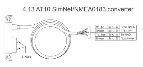

The AT10 cable has the following connections:
AT10 Cable.PNG (32.79 KiB) Viewed 26843 times

If indeed the Calypso device will output NMEA-0183 sentence MWV then connecting to another NMEA-0183 device ought to be straightforward.
The signal that Calypso calls "Data A" is better named TALKER A. I don't know the wire insulation color.
The signal that Calyypso calls "Data B" is better named TALKER B. I don't know the wire insulation color.
To interface to NMEA-0183 you connect TALKER A to LISTENER A and TALKER B to LISTENER B.
On the SIMNET device, based on the legend in the illustration above, the input signals are
LISTENER A = WHITE
LISTENER B = BROWN
This wire insulation scheme is actually backwards, as normally in proper NMEA-0183 wire insulation colors WHITE and BROWN are TALKER A and TALKER B, but I suspect that SIMRAD did this intentionally so that when interfacing their device to a NMEA-0183 device the wires could be connect to color-on-color, making the interconnection simpler, perhaps in the minds of the SIMRAD engineers.

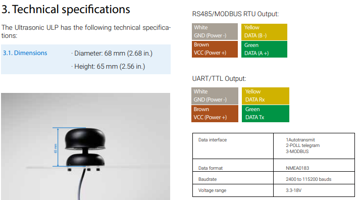

I don't know if it will help or not [IT DOES NOT HELP], but to give you the most information, here are the specifications from Calypso [what was posted was an image of URL--please do not post pictures of URL resource, just post the URL. In this case the URL is
https://calypsoinstruments.com/shop/product/ultra-low-power-ultrasonic-wind-meter-6#attr=38,56,65 ]
A page from the Calypso manual:
Calypso Data.PNG (71.83 KiB) Viewed 26824 times
Should I conclude from your comments that the fact that I only saw the 0183 sentence on the laptop when the input from the anemometer was via the RS485 USB converter, is not of significance?
This is a real puzzle for me, but I know I am at the correct place, because it's clear that you know more about this than either the tech support people from Calypso or Actisense. The Actisense guy spent 2 hours on a remote connection and finally just gave up, and Calypso do not seem to know much about this. They just pointed to the AT10 diagram.
I really appreciate your help.

If you can monitor the NMEA-0183 output from the Calypso device and see the NMEA-0183 sentence MWV, and you have properly connected the the NMEA-0183 output to the protocol convertor, the most reasonable conclusion about why you don't see wind speed data on the NMEA-2000 network is the protocol convertor does not know how to convert MWV into NMEA-2000 data.
The speed of the NMEA-0183 connection appears to be variable. I don't know how you would alter the speed. The usual speed for NMEA-0183 is 4800-baud. The baud rate must be set properly in order for the protocol convertor to read the data. Also, what is the protocol convertor expecting as the baud rate?
If the protocol convertor is properly documented, it should give a list of the NMEA-0183 sentences it can convert and the parameter group number (PGN) that they will be converted to.
I also found this sentence on the manufacturer's website:
The Ultra Low Power Ultrasonic wind meter can output an NMEA 2000 signal when using an NMEA Connect Plus NCP_W2000 model.
That seems like the best approach to getting this information onto NMEA-2000 from the device.

From the illustration above, the NMEA-0183 output appears to be
TALKER A = GREEN (inferred from "Data +")
TALKER B = YELLOW (inferred from "Data -")
Note: that is completely backwards from the normal wire insulation color coding.
What is not clear to me: How do you set the output mode?
Apparently you have to make a receive and transmit connection using RS-232. In RS-232 mode the NMEA-0183 signal names would then be
TALKER A = GREEN
TAKER B = not provided
LISTENER A = YELLOW
LISTENER B = not provided
To interface when the device is in RS-232 mode, the connections would then be:
TALKER A = GREEN ---> LISTENER A
Ground = WHITE -----> LISTENER B

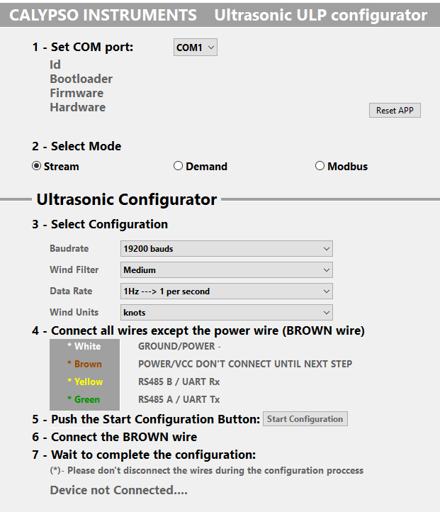

The Calypso is configured using what they call their "Configurator", a program I downloaded to my laptop, and then over that same RS485/USB converter connection, I set up the anemometer. Here is a screenshot of the "Configurator" so you can see what the options are:
Cconfigurator Screen.PNG (31.65 KiB) Viewed 26799 times
I set it at 4800 and "Stream" mode...I don't know if that was correct and the Calypso support people didn't seem to know what should be used for a boat! If you look at their website, they promote the use of the anemometer for many different applications.
I'll go to the boat now and try what you suggested.

I looked at the "Technical Data" sheet for the anemometer and it says the data format is "RS485", but it doesn't mention NMEA 0183 anywhere.
Is there some kind of conversion that takes place to make it 0183?
