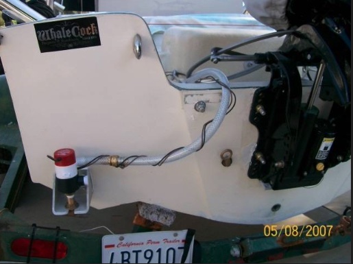

The typical practice of installing a livewell pump is to install a bracket and pump on the outside of the lower transom and route the hose up and over the transom. See below:
Fig. 1. Installation of a sea water pump for filling a live well.
Existing drains in the hull will not provide adequate water volume for the livewell.
