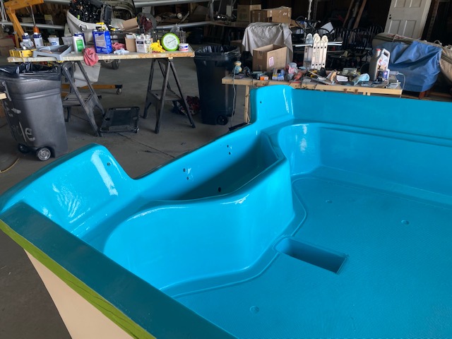

Fig. 2. A second view of the bottom of a hull with the bottom paint partially removed. Compare to Figure 1, above.
Q5: which resin is harder to sand: MARINTEEX or WEST System Epoxy thickened with milled fibers?

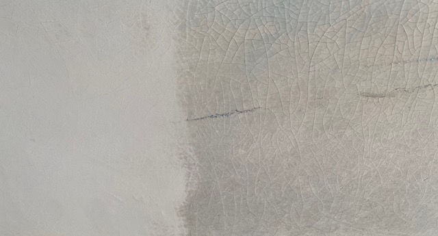

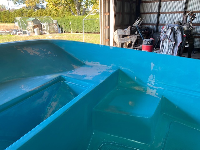

I sanded down the gel coat down about halfway until the crazing cracks were mostly gone.
Fig. 3. Before and after sanding of cracked gel coat surface.
A 5-inch random orbital sander and 80 grit seemed to work best.
I hope that a new top coat of flexible epoxy primer will keep the cracks from reappearing over the years.

Postby jimh » Sun Sep 04, 2022 8:50 am
The pattern in the gel coat as seen in Figure 3 (above) looks remarkably similar to the intentionally molded-in faux leather pattern seen on larger Boston Whaler boats on flat console surfaces.

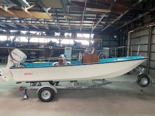

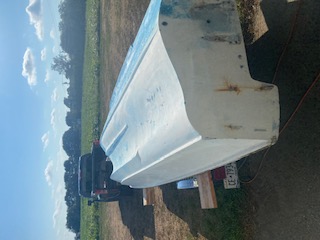

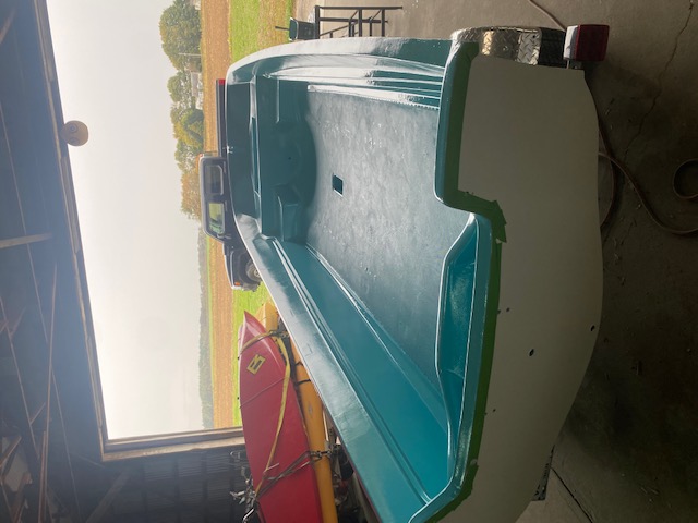

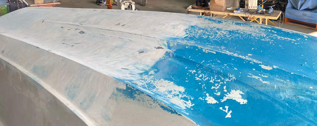

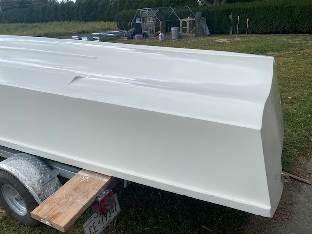

Postby Foamboat » Fri Sep 30, 2022 4:54 pm

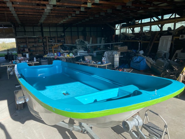

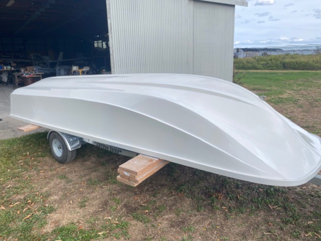

Below is the hull as it now sits after the following process of preparation and painting:
  • strip off the bottom paint using an angle grinder and 60 grit
  • sand down the gel coat until spider cracks were almost gone
  • fix 186 holes or places where the gelcoat was broken down to the fiberglass
  • apply thee coats of Total Boat fairing compound and sanded with 80 grit
  • roll-on three coats of Total Boat two-part epoxy primer; the first coat was gray; the next coats were white so I could see what I was taking off while sanding with 80 grit; final sanding with 120 grit.
  • apply four coats of Interlux Perfection two-part [later clarified to be an polyurethane] gloss paint using quality foam roller and hand sanded with 220 grit pads between coats; thinned the paint 9:1 with the recommended thinner; air temperature was about 70-degrees-F.
NOTES:
  1. I found if I used 60-percent of the hardener recommended the two-part [polyurethane] paint seemed to flatten out better.
  2. Always wear a respirator when painting and sanding with these toxic paints.
Fig. 4. Repainted hull.
Fig. 5. Closer view of repainted hull.

Postby jimh » Sat Oct 01, 2022 8:15 am
Foamboat wrote:I found if I used 60-percent of the hardener recommended the two-part epoxy paint seemed to flatten out better.
Q6: Did the manufacturer of the two-part epoxy paint specifically recommend or endorse the use of non-recommended portions of the epoxy resin and hardener materials as you have done?
I am asking because an epoxy resin and hardener reaction MUST be done with the the exact specific volumes of each reagent. Epoxy resin mixed with only 60-percent of the volume of hardener recommended will result with 40-percent of the resin remaining uncured. This results in a much weaker cured material. There is generally never any reason to alter the proportions of resin and hardener in using epoxy. Unless the two-part paint manufacturer endorses and recommends using a different volumetric ratio of the reagents, I would think experimenting with those ratios would be likely to leave parts of one reagent out of the reaction, resulting in a contamination of the final resin cure.
Foamboat
Posts: 32
Joined: Fri Jul 29, 2022 10:47 am
Re: Painting and Fairing Older Hull
Postby Foamboat » Sat Oct 01, 2022 9:10 am
It is now over a week since the final coat. I left it alone to cure slowly. It seems very hard and tough. I think it just cured more slowly. We will see.
Postby jimh » Sat Oct 01, 2022 9:37 am
Foamboat wrote:It is now over a week since the final coat. I left it alone to cure slowly. It seems very hard and tough. I think it just cured more slowly.
I interpret you answer as "NO." That is, the manufacturer did not instruct you to intentionally alter the proportions of the epoxy resin and hardener with the goal of making a smoother surface finish. If that is wrong, please correct me.
Everything that I have read about using epoxy recommends that the volume ratio of the resin to the hardener is very important and must be carefully measured to produce a proper outcome.
Epoxy resin is not in the process of curing in the can like polyester resins. A volume of epoxy resin will remain a liquid for many decades without any sign of curing into a hard and strong substance. Epoxy resin cures by a chemical reaction with its other component, called the hardener. Like any chemical reaction, the reagents combine with each other in a set proportion. That is why directions for use of epoxy always specify a certain volume ratio of the two liquids, and that they must be very thoroughly mixed together before applying them.
Maybe the so-called two-part paints are not the same as epoxy adhesive resins. I would only change the mix ratio of an epoxy material upon advice and blessing of the manufacture of the epoxy.

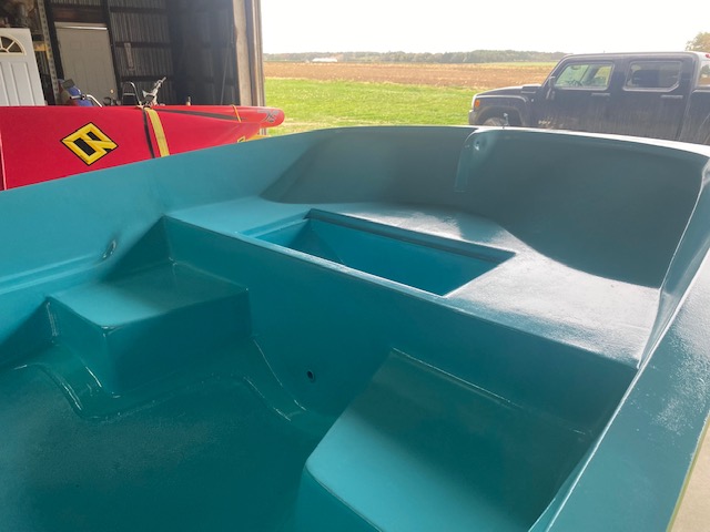

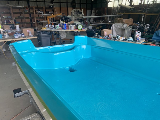

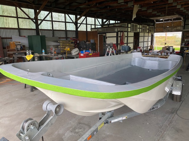

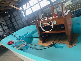

The [1967 NAUSET 16 that is being refurbished and discussed in this thread] is now right-side-up on the trailer.
The interior does not have many stress cracks and the molded-in non-skid looks really good. I didn't want to sand on the non-skid so I used a stainless steel wire wheel to clean out the pattern. On the non-skid I plan to [apply] one thin coat of Total Boat two-part primer and follow that will one coat of Total Boat Wet Edge in Whaler Blue.

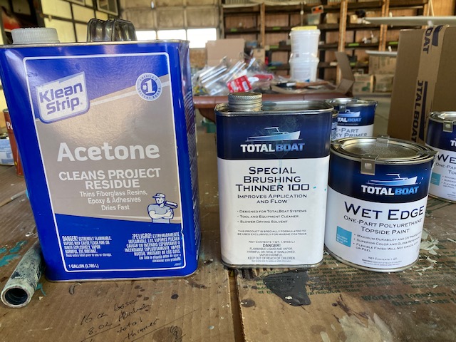

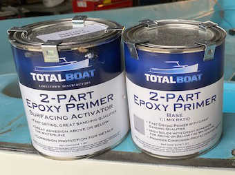

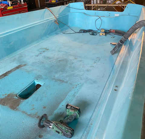

Fig. 6. Two cans of paint with labels and very unusual retainers holding the lids in place.

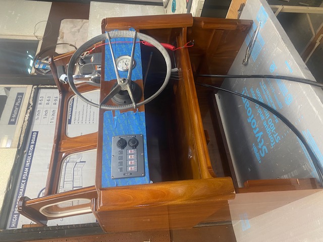

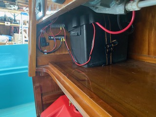

Fig. 7. The boat cockpit with tools and extension cords visible. This view shows the rigging tunnel exit normally hidden below the console.

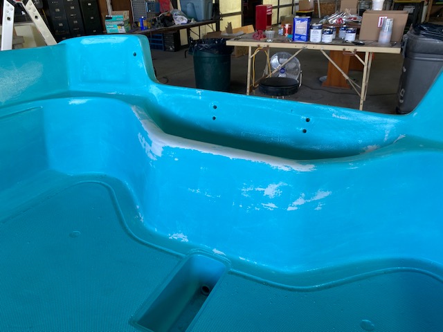

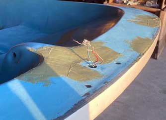

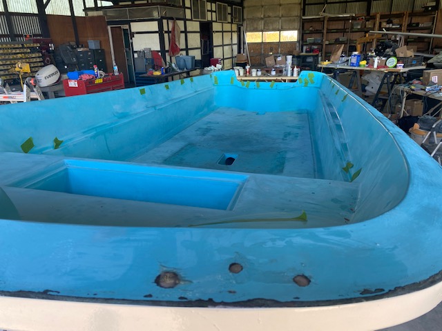

The rest of the interior has been sanded with 80 grit to remove gel coat with oxidation, and to prepare the surface for good adhesion to the primer paint.

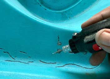

140 HOLES
I will inject Smith's clear penetrating epoxy into each of the 140 holes that have been drilled. Then I will fill the holes with West System epoxy mixed with milled fibers using a big syringe. Then I will grind off the get coat around each hole with my mini belt sander and apply two layers of glass. This should end up below the existing gel coat level. Then I will fair everything out using Total Boat fairing compound.
Next I plan to apply two coats of two-part primer. I like to use gray for the first coat and white for the second which makes [it seeing how much surface has been removed easier when] sanding. Then I will apply two coats of Wet Edge, while sanding in between with a 220 grit pad.
I hope to get all this done before November 2022, when I will be out of commission myself due to a surgical procedure.

RECENT WORK
  • finished sanding the interior with 80 grit
  • used a wire wheel brush on the nonskid
  • squirted Clear Penetration Epoxy Sealer in all the holes drilled in the hull
  • put West System epoxy thickened to toothpaste consistency in each hole with a syringe
I used green masking tape cover the horizontal holes to hold the resin place until it hardens. The resin does not seem to stick to the tape. Among the railing mounts, the bimini mounts, the trolling motor mounts, the battery box mounts, the console, and the seat mounts there were 145 holes in the hull.

Fig. 8 A very wide view of the boat hull during renovation and the interior of the building where the work is being done. In the foreground are three holes that apparently have been repaired as described above.

Today's Work
Fig. 9. A DREMEL TOOL with a very small tool bit was used to widen and deepen a few cracks in the gel coat.
Fig. 10. A fairing compound was applied over the holes that had been filled with resin.

Fig. 10. Interior painting using an epoxy primer paint.
Interior primed with Total Boat 2 part epoxy primer. Some gray some white because that is the paint I had on hand. Got one and a half coats on until I ran out of paint. One more coat (when paint gets here) then two coats of Whaler Blue then the painting is done.
Foamboat
Posts: 32

Fig. 11
Fig. 12
Well, my whaler is back to its correct interior color! There is something about the old blue whalers. To me when they are painted any other color it's not the same. This is coat #1 of 3 thinish coats or Total Boat Wet Edge thinned with 10% thinner. The Wet Edge paint does not seem to destroy foam rollers as the two-part primer did. Thinned 10% one quart covered the entire interior including the floor. On the non-skid floor, I did just one coat of two-part top-side primer and one coat of the Wet Edge blue because I do not want to fill in the nonskid texture. I found painting the non-skid part a 1/8" nap fuzzy roller worked best.
Foamboat
Posts: 32
Postby Foamboat » Sun Oct 23, 2022 3:29 pm
Fig. 13.
Fig. 14.
Fig. 15.
In an effort to share knowledge, I want to tell you about a screw-up. After the first coat of Total Boat Wet Edge Whaler Blue, I sanded lightly with an 80-grit pad and then vacuumed up the dust. I then proceeded to start wiping down with acetone on a rag. The paint immediately bubbled up like I had used a paint stripper. (See photo of the bow). Luckily I only did a little. Next, I tried wiping it down using Total Boat Special Thinner 100. The same thing happened just not as aggressively (see picture of stern). This may have occurred because the paint was pretty young about 20 hours since painting. I resanded down those areas and just used a brush and strong vacuum to get up the dust. I think painted coat #2 with no problems. This morning I gave a light hand sanding with a sanding pad and put on coat #3. I was debating doing only 2 coats but expect dropped anchors, tackle boxes, etc. The non-skid floor has only one coat of 2-part primer and one coat of wet edge so the non-skid does not get filled up with paint.
The painting on this project is now done. Next is the installation of the console, seats, engine, controls, etc. There will be a delay on this while I get my hip replaced.

Well, I am finally back at work on [the 1967 NAUSET boat that is the topic of this thread] after getting a total hip replacement.
I am installing everything in the replacement console. I could have made one from the plans but it would have cost almost as much as buying one. Plus I was not able to work much in my shop.
Fig. 19. The replacement Center Console with new electrical and engine controls installed. Later steering wheel was cleaned and is now white again.
The new console is ready to go back in. I wired everything I could while on the bench. The original 1967 steering wheel cleaned up nicely and looks cool. I added a new Raymarine chart plotter and SONAR fish finder [not shown], and USB ports for charging telephones.
I was able to reuse the steering and controls after some rewiring.

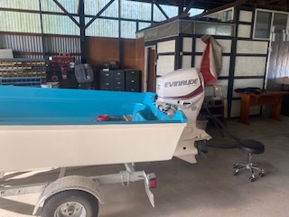

Fig. 20 The E-TEC 90-HP engine has been re-mounted on the boat.
Progress has been made.

Foamboat wrote: I used shrink-wrap tape to hold all the lines together while pulling them through. Shrink wrap tape sticks like crazy so nothing will come apart halfway through.
A day may come when you regret having all the cables and lines in the rigging tunnel wrapped together in a strong tape. As a general rule, anything hidden in a rigging tunnel will be a problem to access.

Just to clarify, the shrink-wrap tape just was to hold all cables together as I pulled them through. All the taped parts came out on the other end. Every wire, control, and fuel line can be pulled out separately.

Postby Foamboat » Wed Apr 12, 2023 2:27 pm
The Boston Whaler 1967 NAUSET 16 restoration is essentially done.
I added a strong swim platform with four steps down into the water.
The project came out well and I am 99-percent-sure all the holes I drilled are waterproof.
I used 3M 5200 in all the holes and in addition Butyl tape under all fittings.
A useful tip is to have a can of CRC handy when using 5200. Spray your hands with it first. It allows easy clean up of 5200 until it hardens.
This total rebuild of the 1967 NAUSET 16 was just a winter project and was not restored to show-boat standards. The grand kids will be tubing and wakeboarding with this 1967 NAUSET 16 boat for years, and the boat will have many slimy fish pulled aboard. I did the best I could in just a few months. Plus, I had total hip replacement in the middle of the project.
I was 10-years-old in 1966 and drooling like crazy over this 1967 NAUSET 16 model. Now I am 66-years-old and owning one has been a bucket-liist item.
The plan is to keep the 1967 NAUSET 16 on the beach in front of our house. Wm. J. Mills & Sons canvas is nearby and is making a mooring cover. We will use a four-wheel-drive tractor to launch the boat
I hope this thread will help others to restore these great boats.
