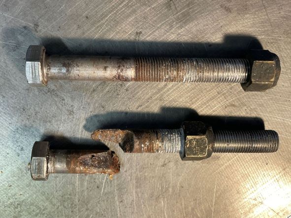

I was pulling off the 1990 90HP Mercury outboard from my 1990 Montauk 17 today in preparation for installing a hydraulic jack plate. Three of the mounting bolts loosened up smoothly, but the starboard lower bolt head initially felt very tight and then rotated quite easily as if broken. Here is a picture of the broken bolt.
Broken engine mounting bolt (with intact bolt to compare)
Outboard motor bolt fracture 2.jpg (63.08 KiB) Viewed 3726 times
A few things look unusual to me:
  • The break is on the unthreaded part of the bolt. Isn't this supposed to be stronger than the threaded part?
  • The break is quite oblique, not like what I typically see when I break off a rusty bolt trying to extract it.
  • The fracture surfaces are rusty. I suspect this break occurred long ago, perhaps even during installation of the motor.
The bolts all appeared normal externally before extraction, with 1.5-inch-diameter washers supporting the bolt heads on the inside of the boat. The gel coat wasn't depressed by any of the washers. Note that the break was located 0.5 to 1.25 inches from the bolt head, which places it completely within the 2-inch-thick transom (rather than at the interface between the transom and the motor bracket), so I doubt that the bolt was fractured due to operating in rough seas.
Q1: could this have occurred from the dealer using an air impact wrench to install the bolt?
Q2: is there another explanation?
I will be replacing all four bolts with a jack plate bolt set from Bob's Machine.
Q3: how can I prevent this from happening in the future?
Michael
1990 Montauk 17’ w 2024 Yamaha F70LA outboard
1995 Aquasport Explorer 245 w twin 1995 Yamaha 150 HP outboards

I would suggest there was a defect in the material.
In 20 years on the forums, this is the first incident I have seen.
Don't need to dwell on it.

I agree with Phil.
The bolt seen in Figure 1 looks like if anything was awry it was the amount of sealant used on the bolt. All things being said, it is stain-less not rust-less steel. It may have been 308 stainless steel instead of 316 which has much better corrosion resistance and should always be used in any watery environment.
Keep in mind that most stainless steel bolts sold in hardware stores and Lowes and Home Depot are 308 stainless steel at best and from a third-world or fourth-world country. Use McMaster-Carr for the underwater and similarly important fasteners. At least you will know what quality stainless steel you are getting.

Postby jimh » Thu Dec 01, 2022 11:06 am
msteinkampf wrote:The new engine mounting bolts will not be installed using an impact driver.
Engine mounting bolts should be tightened with a torque wrench to the specified value of torque. If a great deal of sealant is smeared onto the thread, the sealant may act as a thread lubricant and cause too much tightening before hitting the torque value specified.
