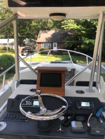

Fig. 2. The helm console.

Your unidentified model-year OUTRAGE 25 CUDDY "Hardtop" is more like a large T-Top. Typically a hardtop would be supported from its perimeter, while a T-Top would be supported from its center by supports from the center console, which is more like the configuration on your boat.
In Figure 2 the helm console looks like a modified Super Console. The metal framed windshield has been removed. At first glance I could not understand why there was an asymmetrical support tube only on the Starboard side of the console, but after some more study I am guessing that tube is actually not a structural support. It is probably a rigging tube to allow wiring to the overhead console.
If that "hard top" were added by Boston Whaler, I don't think they would have added that rigging tube only on one side, as it just creates a very odd and out-of-balance appearance.
The almost vertical orientation of the steering wheel axis is quite interesting. Having the steering wheel in that orientation is more nautical than the usual horizontal axis orientation seen on modern boats which is more akin to an automobile.

I would concur with all of your comments. The asymmetrical support is a rigging tube. I could add a second support on port side, but that would be too busy for me.
The orientation of the wheel is one of my favorite features of the helm.
The metal framed windshield was much too much busy for me.

I love my custom teak electronics box. Who says you cant have a little “Carolina” in Rhode Island?
