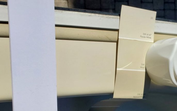

Q1: what color gel coat was used on a 1992 13-foot hull for the interior? I need to know so I can buy a Spectrum Gel Coat Patch Kit.
Fig. 1. Cockpit gel coat color in daylight. A paint color strip and some "white" objects are also in view. [This image is taken from above and is looking downward at a gunwale and cockpit area.]
The area of the cockpit gel coat seen in Figure 1 was wet sanded with 2000-grit, buffed with a heavy-duty compound, and finished with 3M Marine Finesse-it. I believe it to be very close to the original color.
ASIDE: I believe the interior gel coat to be the same color as the hull gel coat.

The cockpit gel coat color is Desert Tan, a custom color by Boston Whaler that does not exist on a Pantone Matching System (PMS) color chart or on paint manufacturers' color charts.
Q2: What repairs are you planning that will require a gel coat color match?
