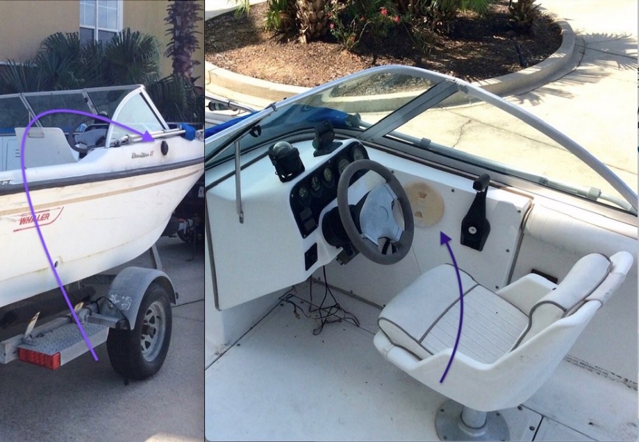

For this generation of boat the fuel filler cap the vent were combined. To replace the entire fitting in the hull may be easier [than getting a replacement for the missing cap]. This can be a do-it-yourself project using basic tools and skills.
In looking on the web at a 1996 Dauntless 17, I believe the fuel fill fitting cap is on starboard side, amidships, adjacent to the steering wheel and side mounted engine remote controls
Fig. 1. A 1996 Dauntless 17 Fuel Fill Cap and inspection Port
Q4: does your 1996 DAUNTLESS 17 boat have a round inspection cover mounted on the side panel as shown in Figure 1, above?

PHIL T: thank you for the information. I went to the storage site and did find an inspection plate that gave access to the 1.5 inch fuel supply hose and a smaller separate vent line attached to the fuel fill fitting, using two hose clamps on the large hose and one clamp on the vent hose.
I will need to get an articulated small ratchet wrench in there as they are about seven inches inside the hull--but [access to them] should be doable. Once [the original fuel filler fitting is] removed, I should be able to [find an aftermarket fitting to match the original].
If [later when I am actually operating the boat and engine] I have any concerns with the [engine fuel] supply, I will consider the second advice, and I run a vent through the hull. But first, I will try an aftermarket vented fuel filler fitting--if I can find a match.
