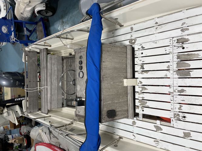

I am a Boston Whaler fanantic and have owned a 13-footer and a Montauk 17. I have found a SAKONNET for sale.
The SAKONNET is in poor condition and is way overpriced; the hull seems solid. I consider this model to be rare, and I am inclined to overpay to get my hands on it. This SAKONNET is unaltered since new, which is also somewhat unusual for a 1974 model; almost every [similar old Boston Whaler] I see is modified somehow.
Give me an assessment of the SAKONNET as [seen below and as described above].
Q1: is a SAKONNET as rare a find as I believe it is?
Fig. 1. A SAKONNET in its current condition.
IMG-7659 (1).JPG (150.77 KiB) Viewed 4270 times

The wood condition is hard to assess from a photograph. If the wood is solid and without rot, then the wood could be refinished and reused. However, I believe some elements of the console and seat were made from plywood, so the hardwood veneer layer may not have enough thickness to permit proper sanding yo good wood.
If the wood is rotted, then its value is only as a pattern to make a duplicate from new wood, a task that would require very skillful work.
The console windshield is missing.
The canvas is NOT the OEM Wm. J. Mills & Co. product.
Assessing the hull condition from a photograph is also difficult.
Determining where the boat has been sitting unused for the last several decades may be a clue to the wood and hull condition.
There is a tendency for owners of older classic Boston Whaler boats in rather poor condition to put their asking price much higher than a buyer would expect solely on the basis of the boat being a Boston Whaler. Any other 50-year-old 16-foot boat with dried out wood and in dirty condition would be lucky to fetch an offer of $250.
The SAKONNET was the most expensive model in the 16-foot line, and the higher price likely contributed to fewer SAKONNET boats being sold compared to similar models like a NAUSET.

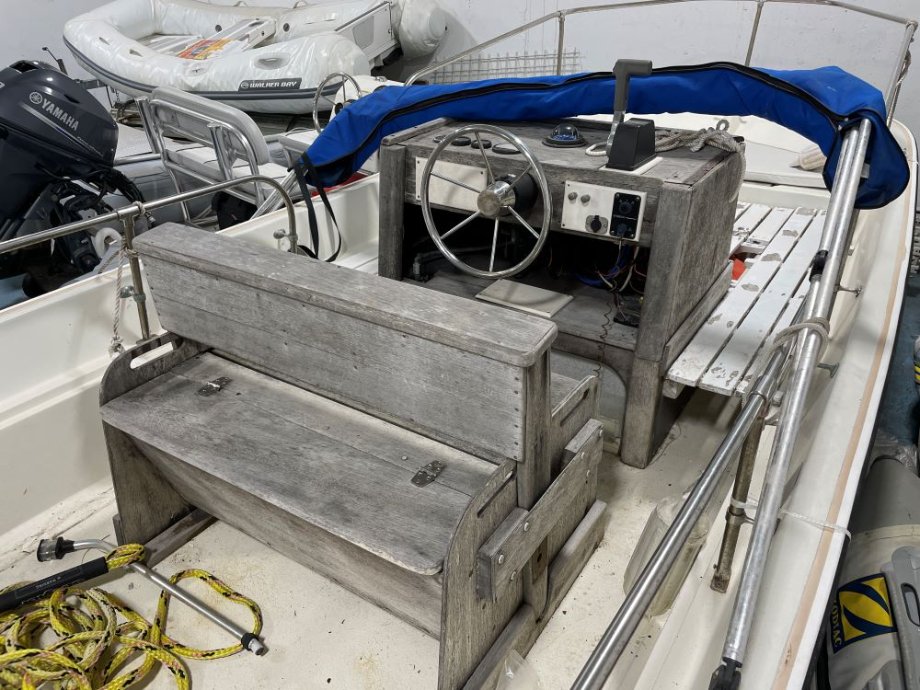

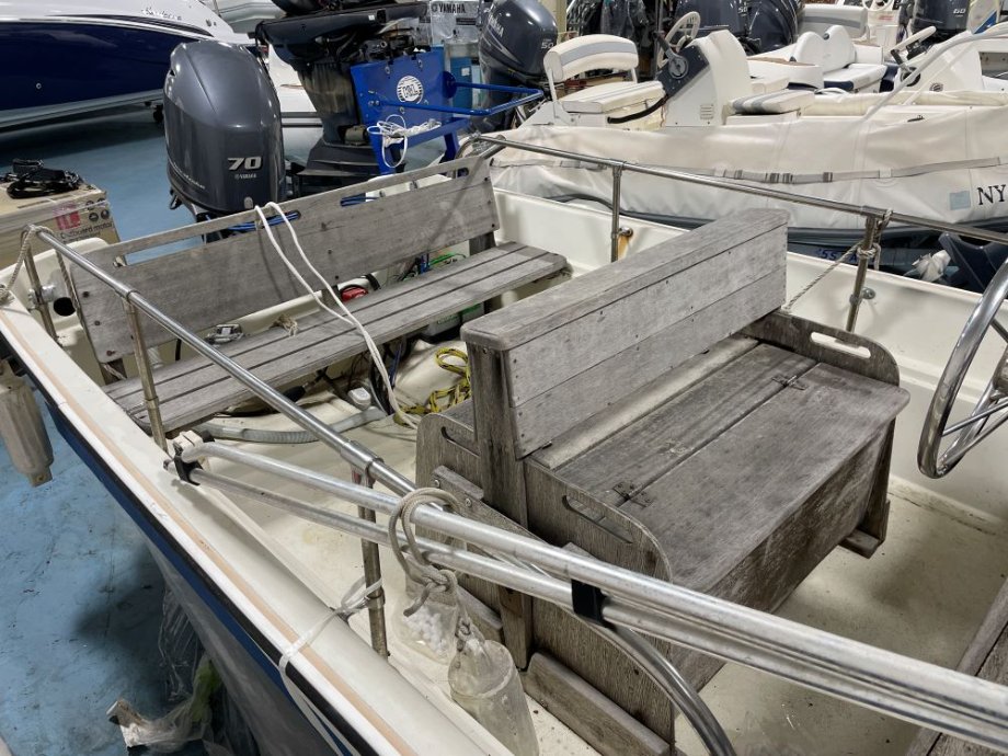

Two photos:
Fig. 2. A SAKONNET
Fig. 3. A SAKONNET

As long as the veneer on the plywood has not lifted off from the underlying layers, there is a good chance it could be brought back to a presentable appearance.
In the last 20 years at least five or six small shops have been in the business of fabricating replacement wood parts for Boston Whaler boats, and they all gave up after relatively short times in that marketplace. In comparison, Specialty Marine has been around for quite a while. I have not dealt with them myself, and thus I don’t have first-hand experience to permit me to offer an opinion. I do note that there is a wide range in buyer satisfaction with their products expressed in prior discussions.
In Figure 3 there is something that looks odd attached to the forward face of the center console at the baseline. It looks like a metal strap. I don’t think that would be OEM.
The missing board in the bow platform should be easy to replace. I think the platform was not made from a fine hardwood. It may have just been pine boards, and that is why it was always painted white instead of left to a natural wood finish. Dick Fisher was a practical guy, and something that would be walked on would not be varnished.
The Yamaha F70 engine adds considerable value to the deal.
