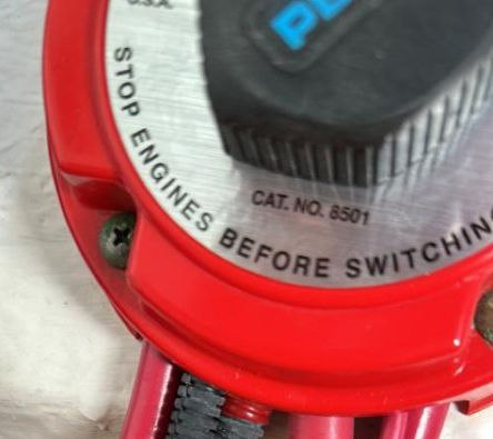

The boat has two batteries which are in good condition (load tested by the mechanic) however we have an problem starting the engine when the switch is on 2 (versus on 1). Electrics run fine off the second battery and the voltage is good (no low voltage alarms on the Verado) it's just the cranking. Our Verado certified mechanic (in Croatia) has diagnosed it to a faulty Perko switch.
Fig. 1 Extreme close up of OEM PERKO battery switch showing model designator 8501.
I've emailed Sue as she is always helpful in sourcing parts for us and mentioned that the 8503D switch is used however I asked my dad to take picture of the switch to be replaced and saw its actually 8501. Sue is probably reading through the Boston Whaler manual and the books says its 8501. I will send her a picture and ask her again.

I looked at the Boston Whaler electrical diagram for a 2009 210 VENTURA in order to see it there was any addition circuit connected to the battery switch, such as an alternator field disconnect circuit. None was shown.
In your initial narrative you seemed to say it was Sue who recommended using the battery switch with the alternator field disconnect circuit, but now it seems she might have done that based on what you (incorrectly) told her about the battery switch that was already installed on your boat
Now that the OEM switch is clearly seen as the model 8051, I see no reason to change to a different model with an alternator field disconnect switch which costs twice as much as the original switch.
