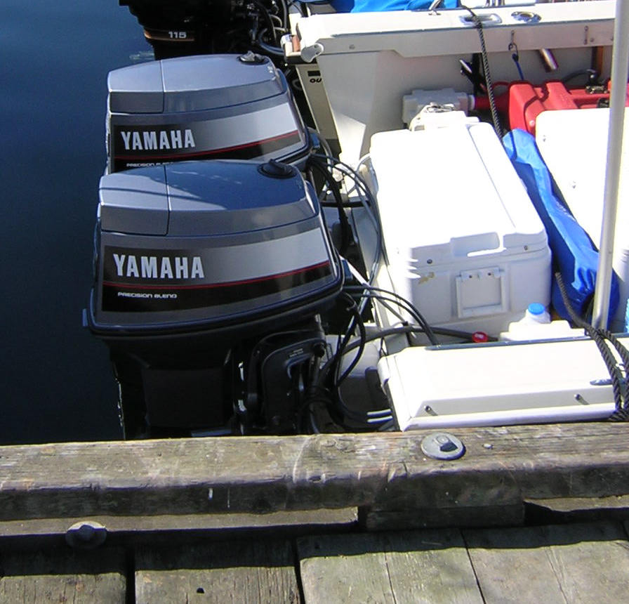

I owned a REVENGE 20 W-T for several years. In order to stretch the deck space, I mounted the outboard engines on 10-inch set-back brackets. This put all the outboard engine rigging, cables, and steering aft of the actual transom. As a result the engine splash well was completely empty, other than the two battery boxes.
I kept the engine splash well overboard drains plugged. The splash well then became a dry space, and I used it for a cooler. I installed a small centrifugal pump in the splash well to remove any water that might accumulate there. With this approach, I essentially got two feet more cockpit space.
Fig. 1. The engine splash well on a REVENGE 20 W-T repurposed to be useful space. Photo by the author, taken September 2003 at Lund, British Columbia, Canada.
