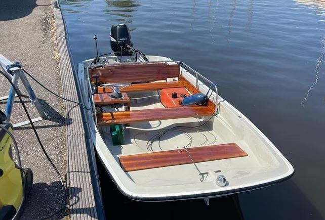

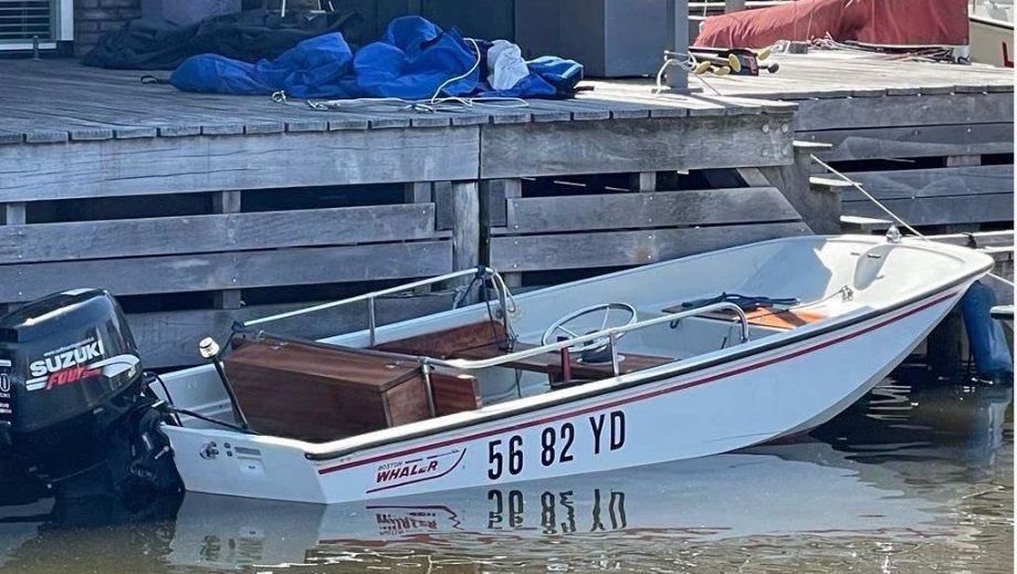

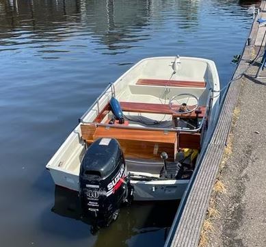

From the three illustrations below, identify the model of the Boston Whaler boat.
I think the boat is a 13 SPORT with a Sourpuss seat option.
Fig. 1. A boat to be identified and appraised in value.
Fig. 2. A boat to be identified and appraised in value.
Fig. 3. A boat to be identified and appraised in value.
From the three illustrations, assess the value of the Boston Whaler boat in terms of a fair price you would pay for it.

[The boat] may be SUPER SPORT in good condition with modern four-stroke-power-cycle engine.
The engine is not clearly visible but could be a 40-HP engine.
On the northern Gulf of Mexico in the USA, the boat shown $8,000 USD assuming it comes with a trailer in good condition.

The boat seen in Figure 1 looks like completely different boat from the boat seen in Figure 2 and Figure 3.

I think Fig. 1 and Fig 3. are the same.

This thread is really an eye test. I do agree the odd railing configuration is the same in all three photos. Maybe it’s the same boat in all three views. If the boats are all the same, Figure 1's photo must have been taken under completely different lighting conditions. In Figure 1 the hull color is markedly different from Figures 2 and 3.
IDENTIFICATION
The hull looks like a 13-footer, a smirked hull with a 20-inch transom height. The interior wooden components don't look quite like a SUPER SPORT model. The railing is unusual, but I think it has been seen before in the SOURPUSS, but usually with the steering wheel on centerline.

Figure 1 shows the engine is too heavy, which reduces value (for me). Also, the appraisal would have been higher if you had NOT shown that photograph with the static trim so high in the bow and so low in the stern.
There are no seat cushions. If I were to buy this boat, the first thing I would have to do is have seat cushions made. You cannot sit on a bare wood thwart seat for very long unless you are under 30-years-old.
Those large hull registration numbers suggest the boat in not in the USA or Canada. Appraisal in a foreign country is impossible. I can only offer what I think the boat might sell for in the midwest of the USA.

Thanks all. I can assure you it's the same boat in all pictures.
I am being thrown off by the the Sourpuss rail used with a normal Sport wood interior, and also having a wooden backrest and some kind of storage.
The boat is in the Netherlands. I am going to go have a look next week. To tell from the pictures what state the boat is in has been difficult.
