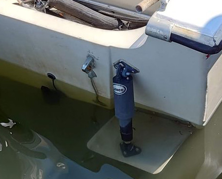

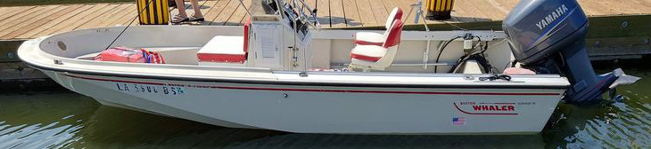

I had the 1982 OUTRAGE 18 boat with 40-gallons of fuel and a Yamaha 150-HP two-stroke-power-cycle engine on the water for the first time, and, to my eye, everything seemed fine.
Transom freeboard = 20-inches
Transom splash well = bottom of drain was just above the static trim waterline
Fig. 1. Splashwell drains relative to static waterline.
FIg. 2. Waterline at static trim.

Figure 1 shows the engine splash well drains right where they should be. They are acting as drains, and NOT letting seawater INTO the splash well but letting water from the boat drain OUT to the sea.

Those upholstered red seat cushions are a bit unusual. On the next refit you might think about toning them down a bit.
Also, this OUTRAGE 18 seems to have no railings on the gunwales. Maybe that was an option in 1982, but most OUTRAGE 18 boats I have seen had side railings or a bow railing or both. This one looks a bit naked without any railings. Also, where are the teak gunwales?

I also notice in Figure 2 that the teak doors on the center console have been painted. Removing the paint from the fine teak underneath would be a chore.

jimh wrote:I also notice in Figure 2 that the teak doors on the center console have been painted.
I do not mind [the teak cabinet doors] being [painted] white. I quite like [the apperance of the teak console doors] this way. But the [painted teak doors] need to be re-painted professionally.
