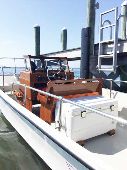

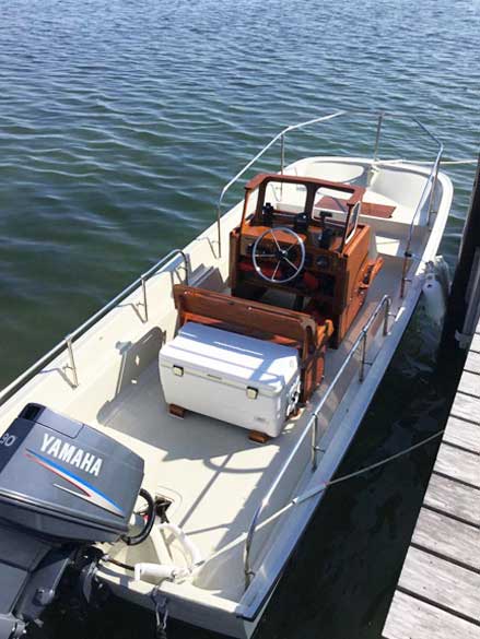

The 50-year-old NAUSET 16 is shown in Figures 1, 2, and 3.
Fig. 1. A NAUSET 16 with all,original wooden components, now reparied.

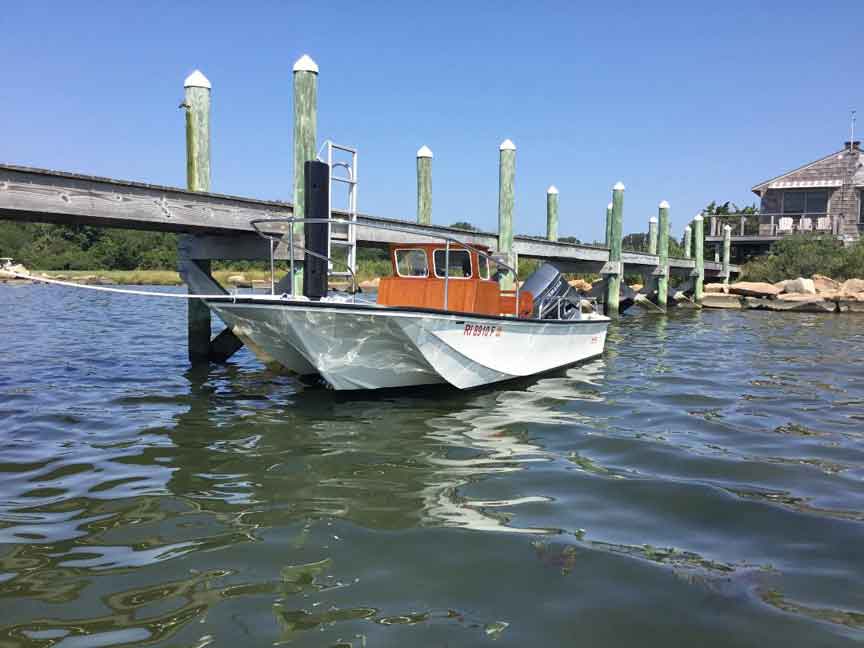

Fig. 2 The dock were the photographs were taken.
Fig. 3. A 50-year-old NAUSET 16.

The boat looks very nice, too. Where is that dock?

Dock is located on Winnapaug Pond in Westerly, Rhode Island. The pond is saltwater and tidal. The location is the west end, north shore. I built the dock 15 years ago. It is 100-feet long, as was needed to get some water depth. The photo from my front yard.
