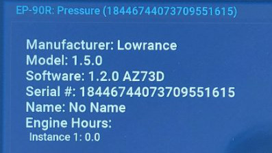

I set-up the GARMIN 943xsv for a single-engine installation, but the GARMIN 943xsv sees two engines on the network: the E-TEC and the EP-90R pressure sensor. As a result, the the GARMIN 943xsv display shows the TRIM data for two engines. I have labeled the LOWRANCE EP-90R pressure sensor as the PORT engine, and labeled the E-TEC as the STARBOARD engine.
Fig. 1. Garmin chart plotter display of two engine TRIM data, but only showing data for the "S" or Starboard engine.
Fig. 2. Garmin "Engine Labels" page showing two engines.
Fig. 3. Garmin page showing network data for EP-90R pressure sensor.

I don't see any simple resolution to the bug in the GARMIN 943xsv where it thinks a pressure sensor is also an engine.
Generally in order for there to be "two" of something on the network, the two network devices must be identifying as the same type of device. The two identical devices are then distinguished by having difference INSTANCE designators. In Figure 2, the INSTANCE setting for both the E-TEC and the pressure sensor is set to the same value: 00. This seems reasonable because the devices are not identical. One devices is an engine, and the other is a pressure transducer.
If GARMIN technical support blames LOWRANCE for this problem, they are just trying to make you go away.
If GARMIN technical support offers no options for their device to remedy the problem, I doubt you can get a remedy from them.
ASIDE: on some E-TEC engines there is an option to install a conventional {non-NMEA-200 type) water pressure sensor to the cooling water system. That sensor sends a signal to the engine management module (EMM). The EMM converts the electrical signal from the pressure transducer into a FIELD in the NMEA-2000 parameter group PGN 127489: Engine Parameters, Dynamic. In the PGN the water pressure is sent in FIELD 8. In this manner, the engine water pressure is contained in the normal engine data NMEA-2000 being produced by the engine. For more information on PGN 127489, see my article at
NMEA-2000 Parameter Groups
https://continuouswave.com/whaler/reference/PGN.html
Generally in order to get the EMM to send this data, the special software EV-DIAGNOSTICS v.5 must be used. However, I do not recall if the 130-HP model provides for this option. (I have the water pressure transducer installed on my E-TEC 225-HP engine and monitor the water pressure without any particular conflicts--but I am not using a GARMIN 943xsv.)
Having the engine water pressure sent by a separate NMEA-2000 device is probably what is confusing the GARMIN.
Regarding the INSTANCE setting of the EP-90R device, the value of the INSTANCE setting may be possible to change to something other than INSTANCE = 00. This would be an interesting test to see what the GARMIN would then do with the data. The problem with trying that is a LOWRANCE display is needed in order to change the INSTANCE setting of the EP-90R.
