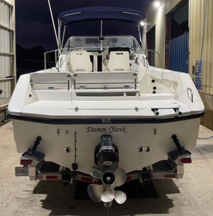

Just before my previous post, I had spent some time looking at Boston Whaler boats for sale on Boat Trader. Of the 1,781 Whalers listed, there were 146 with photographs of the stern for the model years 1967 to 2005. The boat sizes ranged from 11 feet to 32 feet. For the seven boats that were listed as model years 1967-1972, no HINs were visible. There were no 1973 or 1974 boats listed, but all three of the 1975 Whalers listed had metal HIN tags on the port side between the bow/ski eye and the engine. The starboard HIN tag first appeared on two 1977 boats, but there continued to be HIN tags on the port side through 1984.
There were no 1985 boats listed, but all 39 boats of model years 1986 to 1995 had metal HIN tags on the starboard stern. =
Here is a 1990 Revenge 22 with a metal tag.
Fig. 3. A photograph of a a boat said to be a 1990 by an on-line seller with what appears to be a metal tag on transom.

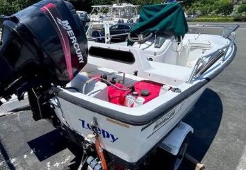

Fig. 5. A boat said to be a 2000 model year with what appears to be a metal HIN tag,
2000 BW w metal HIN tag.jpg (118.09 KiB) Viewed 19819 times
After model year 2000, all HINs were molded in using gelcoat the same color as the hull.

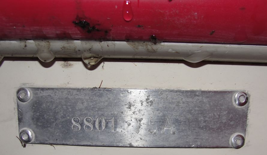

Postby msteinkampf » Wed Dec 20, 2023 3:36 pm

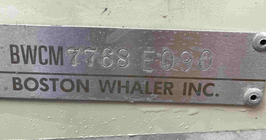

I agree with Jim that relying on the claim of an owner to determine the model year of a boat is a dubious proposition, especially if that boat is for sale, so I respectfully suggest that anyone who wants to post information about a particular style or location for their HIN tag in this discussion include a photo of the tag that has sufficient clarity to show the model/production year and the location of the tag. A photo of the stencil serial number of the hull would also be appreciated. I’ll start with my own boat, a Montauk 17 that I purchased new from Pellegrin Marine in Houma, Louisiana, on November 5, 1990. The bill of sale specifies that this is a 1990 model. Here are photos of the HIN tag, which is located on the starboard transom, and the stencil serial number of the hull. The HIN tag confirms that this boat is a 1990 model that was produced in May of 1990.
Fig. 13. HIN tag on the starboard transom of my 1990 Montauk 17.
MPS HIN.jpg (90.22 KiB) Viewed 19575 times

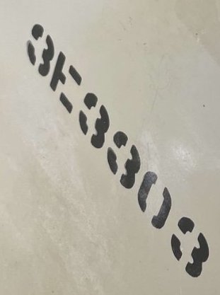

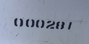

Fig. 14. Stencil number 1990 MONTAUK 17
stencilNumber 1990MONTAUK17.jpg (17.7 KiB) Viewed 19552 times

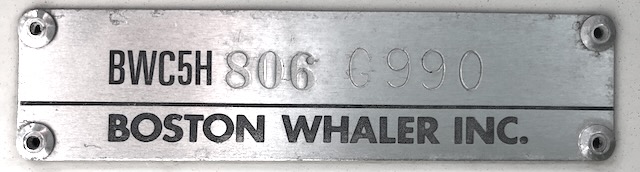

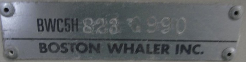

I owned a 1990 Revenge 22 for about 10 years but sold it in 2019. The hull number, BWC5H823G990, was on a metal tag riveted to the upper starboard transom. Here is a pic:
Fig. 15. Metal HIN tag on 1990 REVENGE 22

The hull stencil is shown:
Fig. 17. Hull stencil number

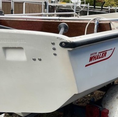

Postby msteinkampf » Thu Dec 21, 2023 8:27 am
Alan-thanks for posting those HIN photographs. I thought that HIN application had progressed from metal tags (up through about 1995), transitioning to molded-in numbers in 1996, but you have dis-proven that. I just found a 1973 Sport 13 with a molded-in HIN on the starboard side.
Fig. 18. Molded-in HIN on starboard transom of a 1973 Sport 13.
HIN 1973Sport13.jpg (33.3 KiB) Viewed 19556 times
(Original photo here: https://www.culversportsidemarina.com/i ... -12146695i)

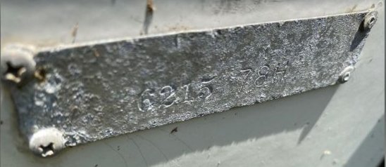

But here is a 1978 Montauk 17 with a metal tag on the port side.
(Original photo here: https://www.boattrader.com/boat/1978-bo ... k-8975899/)
M
Fig. 19. 1978 Montauk 17 with corroded metal HIN tag on port transom.

The metal tag HIN seen in Figure 15 has me wondering if my recollection of the HIN on my 1990 REVENGE 22 was actually molded in or if it were a tag.

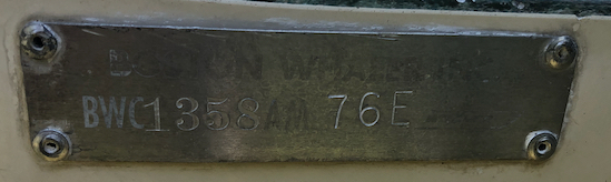

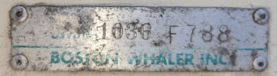

Here is a metal tag HIN from a 1976 SPORT 15 that was for sale about a half-mile from me this summer. The tag was on the Port side of the hull transom.
Fig. 20. A metal tag hin on the transom of a 1976 SPORT 15.
As seen above, the words BOSTON WHALER, INC. were pre-printed onto the federal HIN tag attached to the transom of a 1976 SPORT 15. The manufacturer identity code (MIC) "BWC was pre-printed on the tag, as were the letters "AM" that are part of the production sequence number. The pre-printed elements are still visible, but not particularly clearly legible. This particular boat was a freshwater Great Lakes or inland boat, so the condition of the metal tag is quite good for a 47-year-old boat.

Postby ALAN G » Thu Dec 21, 2023 1:20 pm
We are original owners of a 1975 Revenge 19, [with federal HIN] BWCA8801M75A.
Fig. 22.
R19 Serial Number Plate.JPG (60 KiB) Viewed 19526 times
Age has removed the "BWCA" and "M" from view. Plate is mounted on port side upper transom exterior. FYI stencil number is 000681.

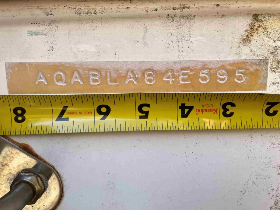

JimH wrote:
The molded-in HIN number seen in Figure 16 for c.1973 hull looks like it was done with a Dymo Tape Label printer. But I am trying to figure out how the process was accomplished. The hull is molded in a female contact mold, so the plastic tape must have been stuck inside the mold for the number to appear on the boat hull take out of the mold. However, the adhesive on the tape would have been on the wrong side, as to get the numbers to read out corrected the plastic tape with the raised letter side would have to have been affixed to the mold surface.
Perhaps boat manufacturers are using a tool that can emboss “reverse image” letters into a flexible tape using a character wheel designed for that purpose. Embossing the HIN backwards with reverse image characters, affixing the tape to the hull mold, and then spraying the tape with gel coat after applying the hull-release agent would yield an embedded HIN of the correct orientation. For example, the DYMO M1011 label maker kit includes a reverse image wheel. The M1101 user guide (available here: https://download.dymo.com/dymo/user-guides/Rhino/rhino-m1011-embosser-kit-user-guide.pdf) includes the following statement:
You can also use a Reverse Image Wheel with the DYMO M1011 label maker. This wheel allows you to print mirror script labels that meet special requirements in the industry. Mirror labels are used on moulds or casts for metal or rubber injection, silicon casting, fiber glass applications, and so on.
However, I suspect that hull manufacturers are not using a DYMO M1101 to create their HIN tapes, as that tool employs 1/2-inch-wide tapes with letters that appear to be only about 3/16-inches high, which is smaller than the federally-mandated ¼-inch letter height. For example, the embedded HIN on my 1995 Aquasport Explorer was made with a ¾-inch wide tape, and the letters are 5/16-inches high.
Fig. 23. HIN on a 1995 Aquasport 245 Explorer
HIN on 1995 Aquasport Explorer 245.jpg (123.34 KiB) Viewed 19372 times
DYMO doesn’t list a tool/tape combination that meets those specifications, and I have not been able to find a product online that does. Perhaps someone who knows a fiberglass boat builder can supply this information.

Postby Kovar » Mon Jan 22, 2024 5:10 pm
I tried to determine the build date of my 1988 SPORT 13. Using the stenciled serial number Boston Whaler was able to provide the correct HIN. On the bill of sale I received when buying the boat the listed HIN was different, perhaps a typographical error. The actual metal HIN tag on the exterior starboard side of the transom was corroded and unreadable.
While recently removing all the wood for refinishing I found another tag attached to the interior of the anchor locker.
Fig. 24. Concealed federal hull identification number. Refer to narrative above for details on location.
As it was on the [aft] portion of the locker, it was not in my line of view when accessing the hold. The tag is riveted and is apparently a duplicate of the one on the stern. The serial number is exactly as indicated by Boston Whaler.
I don't know if this is a common location or if it is usual to have more than one tag.

Postby msteinkampf » Wed Jan 24, 2024 6:10 pm
The duplicate HIN tag on my 1990 Montauk 17 is in the same location. See here for some discussion of duplicate or "hidden" HINs: https://continuouswave.com/forum/viewtopic.php?f=4&t=7600&p=44288&#p44288

Postby Kovar » Wed Jan 24, 2024 6:39 pm
I guess [my 1988 SPORT 13 boat has the concealed second federal hull identification located] in the usual spot.

Postby jimh » Wed Jan 24, 2024 7:03 pm
Kovar wrote: I don't know if…it is usual to have more than one tag.
Federal regulations—which are quoted in the first article that begain this thread—compel boat builders to install a second HIN tag in a concealed location, which is typically not publicly revealed.

Postby msteinkampf » Wed Sep 17, 2025 11:40 am
jimh wrote:The metal tag HIN seen in Figure 15 has me wondering if my recollection of the HIN on my 1990 REVENGE 22 was actually molded in or if it were a tag.
I found a photo of your boat here. It looks like you have a metal HIN tag.
--M

Postby jimh » Thu Sep 18, 2025 12:22 pm
msteinkampf wrote:I found a photo of your boat here. It looks like you have a metal HIN tag.
Thanks for the link to that photograph. Ironically, I was looking for that image for another reason just a few days ago, and I could not find it.
With my own boat no longer in winter storage and now in the driveway at my summer cabin, I can confirm: the HIN is shown on a metal tag.
Fig. 25. A 36-year-old metal tag with the boat's HIN printed and engraved.
My earlier recollection about the type of HIN on my own boat was quite incorrect. I noted the error in my previous statements referring to the wrong method of presenting the HIN with a comment in those posts in square brackets stating the error.
And now that I am really looking closely at the boat's HIN for the first time, I see something interesting. The HIN number is
    BWC5H (printed in ink)
    806 (three engraved numerals completing the five character production code sequence number and in a very stylized font)
    G (engraved letter indicating month of production was July in very thin font)
    9 (engraved numeral indicating last digit of the year of production, i.e. 1989, in very thin font)
    90 (engraved characters indicating model year was 1990 in very thin font)
The different tools used to engrave the two elements in different fonts is also seen in several examples in Figures 13, 15, 20, and 22 above. I had not noticed that before.
Another fact I am just now learning is my boat was manufactured in July 1989, so now, in September 2025 it is 36-years old (not 35-years-old).
Despite the rather old age, all characters on the metal tag are in perfect condition, including the printed-with-ink initial five characters of the HIN. There is no doubt about any character, none are missing. To help maintain the present condition I gave the metal HIN tag a good coating of Collinite Fleet Wax.

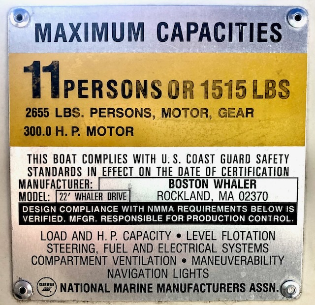

Here is the capacity plate on my 1990 REVENGE 22 W-T Whaler Drive boat:
Fig. 26. Capacity Plate from 1990 REVENGE 22 Whaler Drive
An interesting detail is the plate mentions the Boston Whaler Rockland, Massachusetts site, and from that I infer that this boat was made at the Rockland plant.
