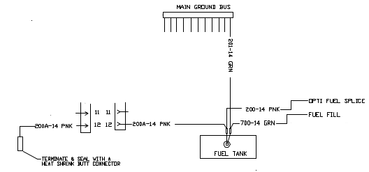

There are two conductors with pink insulation. One pink insulation conductor connects to the fuel tank level gauge. The second pink insulation conductor is connected (according to a schematic diagram) to “OPTI FUEL SPICE.”
Q1: where should the second pink insulation conductor be connected?

Thanks for the response the bar I was referring to is the ground bar didn't mean to leave that off. My only concern is not knowing what the Opti fuel splice (Not misspelled) which is taken directly from the attached whaler PDF schematic. Thanks again for your response.

Thanks for providing the electrical wiring diagram for a Boston Whaler 190 NANTUCKET boat. A schematic diagram is the best way to illustrate and inform about an electrical circuit. Refer to the diagram below for wire identification numbers, wire insulation color, and wire gauge. For example, the conductor identified as "200A-14-PNK" means an AWG-14 wire with PINK insulation is identified as wire number 200A.
Fig. 1. Detail of the circuit for the fuel tank level sender from the OEM wiring diagram.
The notation (in the lower right of the schematic diagram) “OPTI FUEL SPLICE” probably refers to a spliced connection to some portion of a wire harness associated with a particular Mercury Marine OptiMax outboard engine. Exactly what circuit is going to be spliced into is unknown to me.
The circuit at the fuel tank level sender for this wire (number 200) is the HOT side, not the BATTERY NEGATIVE side. Why the outboard propulsion engine would connect directly to fuel tank level sender is a good question. Perhaps the engine has Mercury Smartcraft instrumentation, and the Smartcraft system will be monitoring the tank level. But let's just ignore than for the purpose of installing a different fuel gauge, as you want to do.
If you plan to install a new, dedicated fuel tank level gauge, the new gauge should be the ONLY device connected to the fuel tank level sender. (See below for more explanation for this.) On that basis you should disconnect the PINK wire that is identified as number 200, and leave the PINK wire that is identified as number 200A connected to the sender. Insulate the disconnected wire number 200 so it does not short to ground. Pink wire 200A runs to the helm console. This circuit should be connected to the S or SENDER terminal of the new fuel tank level gauge.
Wires 201 and 700, both 14-AWG with GREEN insulation, should be left in place as originally connected.

I improved the illustration in Figure 1 to show all of the circuits that were attached to the fuel tank level sender.
Regarding my comment above that you should have ONLY the new remote fuel tank level gauge connected to the fuel tank sender unit, I want to explain the reason for this. The amount of current that will flow in the circuit is determined by the resistance of the fuel tank sender unit and the voltage provided from the fuel tank level remote gauge. If there is another electrical element connected to the resistive sender in the fuel tank level sender, this connection will affect the amount of current that will flow in the circuit. As a result the calibration of the remote meter gauge will be affected, and the level indicated by the gauge will not be correct.
Because the sort of electrical circuit that might be connected if you maintain the PINK wire number 200 which is described as being connected to the OPTI FUEL SPLICE is unknown to me, I cannot offer any opinion about what sort of effect this connection will have. So on that basis I suggest you disconnect it.
Also note that in the original boat wiring Boston Whaler has provided a "butt connector" for you to make a connection to the fuel tank level sender from the electric remote fuel tank level gauge. The best way to implement that connection would be to make use of this pre-installed connector.
