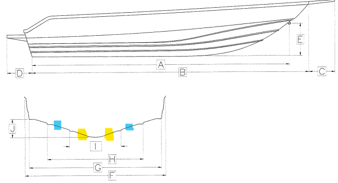

Refer Figure 1 where a drawing contains yellow and blue markings.
Fig. 1. Drawing of the hull of the unidentified boat showing longitudinal and transverse views
Q5: should the bunks be placed in the yellow section of the hull or in the blue section of the hull?

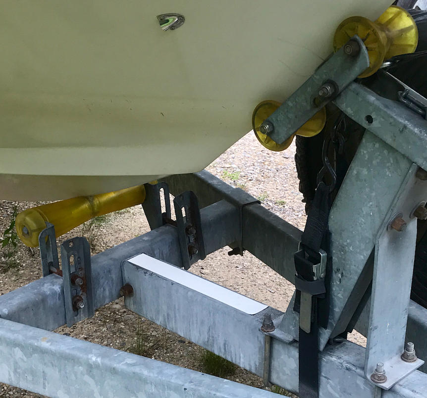

Fig. 2. The floppy rollers and their mounting brackets.

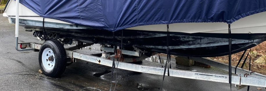

Fig. 3. Trailer in side view.

Postby Phil T » Fri Mar 08, 2024 8:30 pm
I would remove everything that is bolted to the two cross members.
Install 4 2x6 boards (two boards on each side) on pivoted bunk brackets.
https://www.sturdybuiltonline.com/2-Boat-Trailer-Double-U-Bolt-Bunk-Bracket-Swivel-Top-10-Tall-Galvanized-Kit-for-2x3-Cross-Members_p_1824.html
I would also install two 12" non-marring keel rollers on each cross member, one forward and one aft for a total of 4.
https://www.sturdybuiltonline.com/12-inch-Blue-Poly-Vinyl-Boat-Trailer-Keel-Roller-and-Bracket-Kit-for-2x3-Cross-Members_p_1833.html
See Fig 4. in the Reference article on trailering. Link below:
https://continuouswave.com/whaler/reference/trailering/trailer.html
Re: Converting Floppy Roller Trailer to Bunk and Keel Roller
Postby jimh » Fri Mar 08, 2024 10:47 pm
The trailer needs at least one more crossmember, and it should be near the bow of the boat.
Fig. 4. Crossmember and keel roller at bow. This helps stabilize the boat on the trailer and lift the hull into the winch roller slot. A tensioned strap from the bow eye to the trailer frame holds the bow in position so there will be no tendency for the bow to bounce on the highway when towing.
The trailer desperately needs fenders.

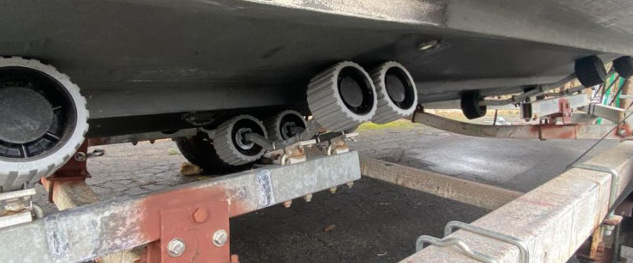

There is plenty of clearance of the boat chines at the tires, and after you add fenders, the chine line of the boat should be positioned so it is about 1-inch to not more than 2-inches above the top of the fender.
Fig. 5. Close-up of boat chine line relative to top of trailer fenders; clearance is about 1.25-inches.
Lowering the boat height on the trailer will give many advantages:
  • the amount of immersion of the trailer needed to get the boat to become buoyant and float off the bunks will be greatly reduced;
  • boarding the boat from the ground when on the trailer will become much easier;
  • the general stability of the trailer when on the highway and at speed will improve as the center of gravity will be lowered with the lowering of the boat; and,
  • the vertical clearance of the boat will be reduced, which can be very useful when towing when you drive under overhanging trees, low overhead canopies at fuel stations or motel entrances, of your storage area entrance.

outrageous210 wrote:Refer Figure 1 where a drawing contains yellow and blue markings.
You really need bunks in both locations.
