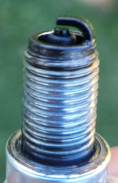

The spark plug from cylinder-2 is shown below in Figure 1.
Fig. 2. The spark plug from the cylinder-2.
The spark plug smelled of gasoline when pulled, and so did the engine exhaust while it was running.
Q2: could something be causing fuel to dump into cylinder-2?

25inland wrote:I bought the LISLE in-line spark tester. The number-2 cylinder seemed to have strong and [continual] spark...The HONDA BF25 still ran exactly the same as before.
I am inferring that what you are reporting was a test situation where after the engine temperature rose to the normal hot engine range and the engine exhibited poor running characteristics, you still had spark indicated on cylinder-2. If that is the case, then lack of spark in cylinder-2 does not seem to be the cause of the poor running. Having a gasoline smell seems to indicate there was un-combusted gasoline in the cylinder. This probably indicates that the mixture of fuel and air introduced into the cylinder was not in the proper ratio.
25inland wrote:Q2: could something be causing fuel to dump into cylinder-2?
Your question seems to presume the cause of no combustion in cylinder-2 was due to the fuel-air mixture being too rich on fuel. It could also be due to the mixture being too-lean on fuel.
As for exactly what mechanical defect could cause either of these could occur I will have to leave the answer to this to others who are more familiar with the intricacies of carburetors on a HONDA BF25.
I will speculate a bit on the possible cause of the too-lean mixture possibility: there is just not enough fuel being delivered, which could be due to one of the fuel orifices being obstructed or incorrectly set. Usually these orifices are threaded and are adjusted by rotating them in or out a few turns. Usually the Service Manual will give advice on how to adjust them.
I will also speculate a bit on a possible cause of the the too-rich mixture possibility: generally in a gasoline engine with carburetors there will be an enrichment circuit that tries to increase the amount of fuel provided in order to encourage starting the engine when cold, often referred to as a "choke" because it can be implemented by reducing the amount of air by keeping the throttle plate closed. But in some designs, the enrichment is created by introducing more fuel than normal. Exactly which method is used on the HONDA BF25 is unknown to me. Nor do I know how the enrichment is precisely accomplished.
You may be able to learn more about the fuel enrichment method from the Service Manual for the BF25 engine.

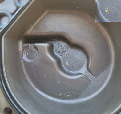

I disassembled the carburetor from cylinder-2. The cause of [the engine running poorly] was immediately apparent.
Fig. 3 The bowl from the carburetor from cylinder-2 with odd yellow debris in the botton; see inset at upper right for close-up view of the yellow debris.
Q3: where did the yellow debris seen in Figure 3 come from?
Posts: 13336
Re: Honda BF25 Runs Poorly
Postby jimh » Wed Mar 13, 2024 7:55 am
25inland wrote:Q3: where did the yellow debris seen in Figure 3 come from?
My first thought was to ask you if while you were working on the carburetor were you eating potato chips?
More seriously, speculating on the source of the yellow debris (discovered in the carburetor bowl from cylinder-2 of the HONDA BF25 engine that seems to run poorly after it has warmed up and is believed to lose combustion in cylinder-2), my first thought is that the debris could not have come from the fuel being used. There is no basis to support the idea that debris in the fuel was always and repeatably settling only in the bowl for the carburetor on cylinder-2. If there were debris in the fuel, it would be just as likely to be found in the carburetors for all cylinders. And here I am assuming that you HAVE already inspected the bowls of the other two carburetors and did not find any odd yellow debris in them. If not, then that action should be your next move.
My second thought is the debris must be something insoluble in gasoline. Gasoline is a very good solvent, so whatever the yellow debris is from, it must be insoluble in gasoline.
On the basis of those two assumptions, a reasonable theory of the origin source for an insoluble yellow particulate that only affects the carburetor for cylinder-2 would be a fuel hose that feeds only the carburetor for cylinder-2.
A troubling aspect of the new theory (that the yellow debris seen in the bowl for the carburetor from cylinder-2 is the cause of the habitual problems with the engine running poorly) is the notion that you have previously disassembled the carburetors for cleaning at least twice (as I recall from your narrative) and apparently did not notice the yellow debris. I would expect that if the yellow debris were the cause of the poor running, the yellow debris would have been present every time you disassembled the carburetors.
Q4: is there a possibility that the yellow debris has always been present and that the two earlier times you disassembled the carburetor you did not notice the yellow debris in the bowl?

Q6: in Figure 3 of the bowl with the yellow stuff, do the other bowls exhibit the same yellow stuff?
All the other carburetor bowls did indeed have the same yellow debris inside them, though maybe not quite as much as the carburetor on cylinder 2.
It is true this is the first time I've noticed the debris but I suppose it's possible I could have missed it the first time, or perhaps the pieces weren't quite as large and noticeable but still able to clog the tiny jets.
Other forum posts mentioned fuel can varnish in the fuel lines and flake off when the lines are pulled and flexed when removing and reinstalling the carburetors from the intake manifold. I feel. that given the age of the 2002 HONDAY BF25a2, the fuel lines could be original. Because I know the previous owner (a friend) and that he used the boat infrequently and didn't use stabilized fuel, this could be a plausible theory.
In any case at the very least it might be good preventative maintenance to replace the fuel lines.
Q8: should I replace the fuel lines?

From the mention of CARB, I infer you are in California. You should be able to buy pure gasoline as aviation fuel. You might check with a local small airport fixed base operator to see if you could buy a few gallons of aviation fuel as a test.
Your new observation that you are now able to observe the yellow debris in ALL three carburetors allows for the fuel, the fuel tank, and the fuel hoses from the fuel tank to the engine's fuel fitting to be suspects as the origin of the debris.
One source of fuel contamination that is well known is from fuel hoses that have a metallic gray appearance. These hoses are FAMOUS for being degraded by use of ethanol-gasoline blended fuel. They have a liner material on the ID of the hose that is affected by the ethanol and breaks apart. If you have ANY fuel lines that are gray and have a metallic finish, get rid of them. Replace those gray hoses with black rubber fuel hoses that specifically state they are tolerant of ethanol-gasoline fuel. By the way, the prices of those rubber hoses is quite crazy. I think I recent paid about $6 a foot for some.
If possible, you should immediately test the engine by running it from a different fuel tank, a tank known to have no debris in it, and with proper rubber fuel lines that are not likely to be degrading from use with ethanol fuel. And running on pure gasoline could also be included in the test.

The fuel tank and hose from the fuel tank to the outboard are only about a year old and there is a filter in between them and the carburetors so I feel like that would be a less likely source of the debris. The hoses distributing the fuel to the fuel pump and the carburetor are a matte gray and look different than the OEM hose that Honda currently produces which are of the solid black type that you mentioned Jim.
Some other posts described "yellow gelatinous flakes" coming out of their old gray fuel lines which closely matches what I've been finding in my carburetor bowls.
I have ordered some new Honda fuel line and will be replacing everything under the cowling. I may also install a new primer bulb.
