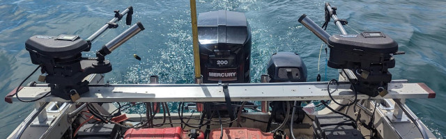

I installed a BIG JON SPORTS brand Downrigger board across the gunwales. The board is used for down-riggers and rod holders.

floater wrote:I installed a BIG JON SPORTS brand down-rigger board across the gunwales.
Does it look like the product shown below in Figure 1?
Fig. 1. A transverse mounting frame used to support large down riggers.
