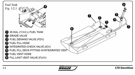

A diagram of the fuel setup is shown below. The fuel system uses EPA compliant"Attwood equipment designed to keep fuel vapors from escaping into the air.

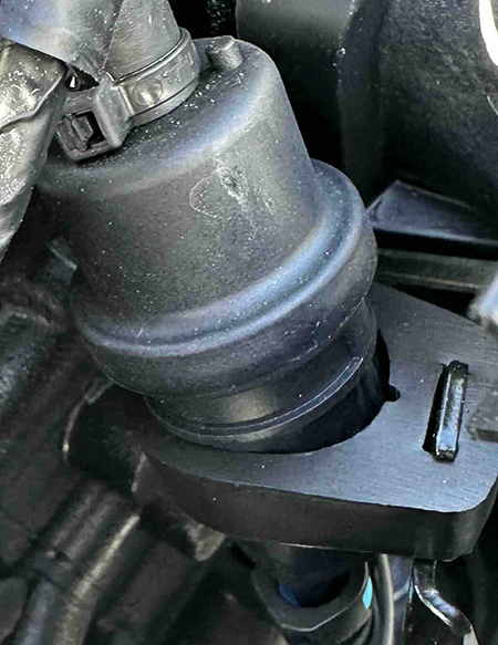

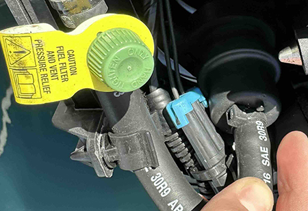

I haven't been able to locate a part number one more filter. I need help identifying the filter shown below in a photograph.The filter in-line with the vent for pressure relief at the top of the engine. I'm think this filter may be a fuel/vapor separator. I can't locate it on the Mercury fuel system diagrams.
FFIg. 1 Filter in-line with vent pressure relief cap
Fig. 2. Better view of filter seen in Figure 1/

Fig. 3. Dauntless 170 Fuel System Diagram

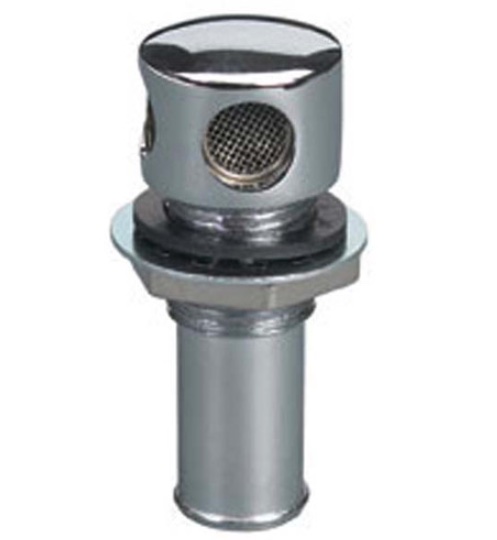

I would remove the integrated fill/vent cap and install a separate fill and vent fittings. The vent goes through the gunwale approximately 1-1/2 inches below the bottom edge of the rubrail.
https://www.wholesalemarine.com/moeller-marine-chrome-thru-hull-fuel-tank-vent.html
Fig. 4. A Moeller thru-hull vent fitting
