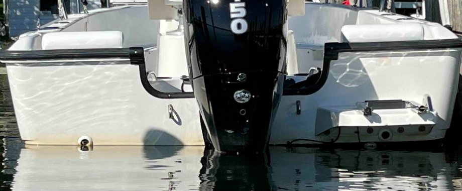

[In an entirely new thread the author says] I posted previously about my [Boston Whaler 2005 190 NANTUCKET boat having ] a lean to port at rest and under power.
[That entirely new thread was on precisely the same topic as this earlier thread. I have combined the new topic with the old topic because the two topics were precisely the same topic. Please do not start a new thread when you purpose is to update an existing thread with new information--Moderator]
I have ensured the additional weight of the batteries as as close to center as possible.
I did re-power with a new 150 [HP engine of unspecified manufacturer and model] last year [i,e, 2023] but the overall [engine] weight change is negligible.
I have confirmed [that in the hull there are] no holes on the [hull] bottom.
As shown below in FIgure 1, [at static trim the hull has] about a 2-inch lean at the stern.
FIg. 1. The static trim of a 190 NANTUCKET showing list to Port.
[The recent behavior of the hull at static trim to list to Port has me] really stumped.
Shifting around people [when underway] nder power to get more weight to the Starboard side so that [the hull] moves through the water at level is not ideal.
Give me [further advice on how to remedy the tendency for the hull of my 2005 190 NANTUCKET boat to exhibit a list to port in static trim].

Postby jimh » Fri Jul 05, 2024 5:34 pm
If the hull exhibits a list to Port when at rest, and the list is not being caused by the mooring lines that tie the boat to the pier, then the only reasonably basis for the hull to list to Port is due to uneven distribution of weight in the hull.
