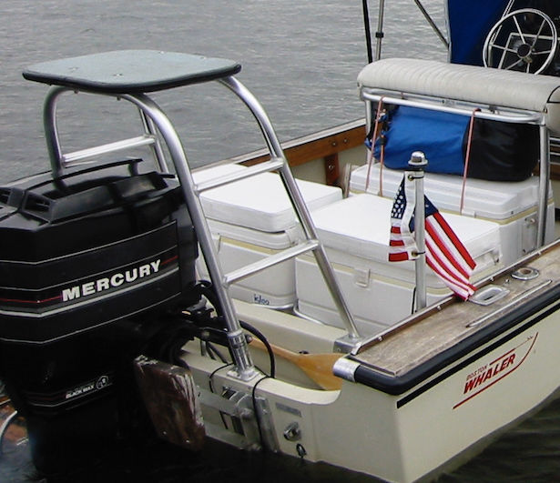

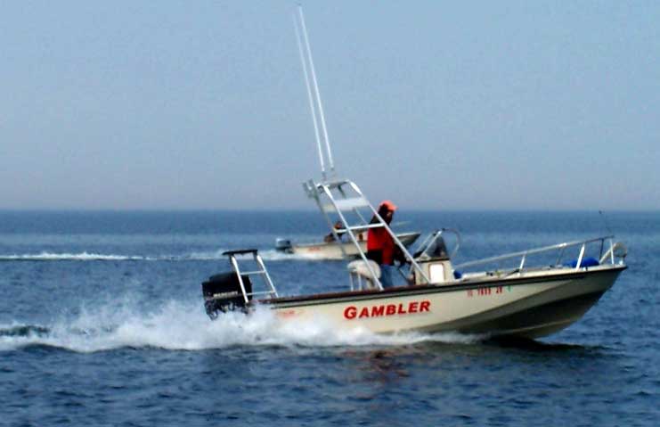

I did find two pictures of a poling platform added to an OUTRAGE 18, the now famous GAMBLER of Dave B (AKA Buckda):
FIg. 1. Poling platform added to OUTRAGE 18.
Fig. 2. Details of mounting of poling platform to hull of OUTRAGE 18.
Figure 2 show how the platform was attached to the hull. After seeing this image I am sure that the platform was custom-made to fit that boat. Here is an interesting aspect: the GAMBLER originally came from Texas, and had that poling platform. On that basis there must be a fabricator down in the Texas area that made that platform. It does not have as many fancy bends in the support tubes, so I expect it would be less expensive that the types shown by Action Welding & Marine Fabrication on their website.
By the way, Dave eventually removed that platform because he later re-powered with twin engines. And I think he sold it.

Ahh, good pics of The Gambler. That’s a very helpful picture and design. I believe I’ll build the one for my 15 in the same way. I also like that it looks to be removable. Simple and easy to fabricate. Thank you.

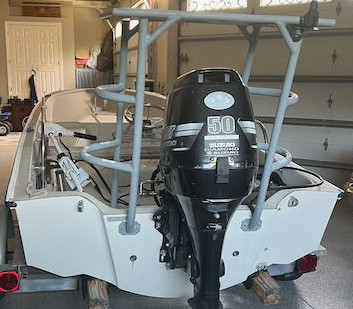

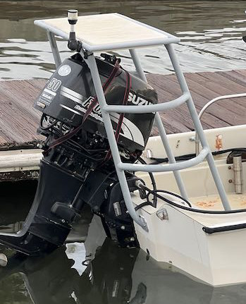

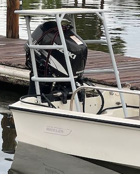

I have a 1978 SPORT 15 with a poling platform.
Fig. 1.
Fig. 2.
Fig. 3.
I bought the boat with it already installed. I may remove it as I do not use it.
