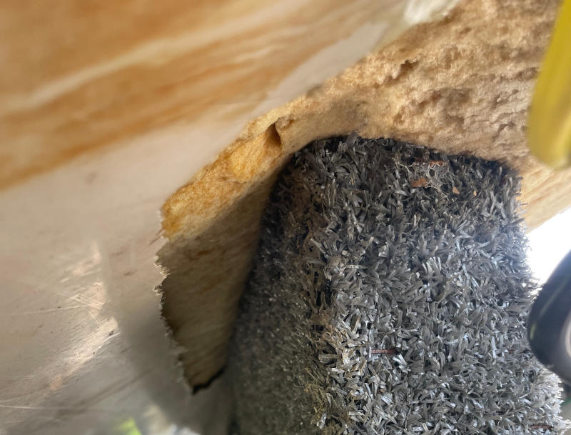

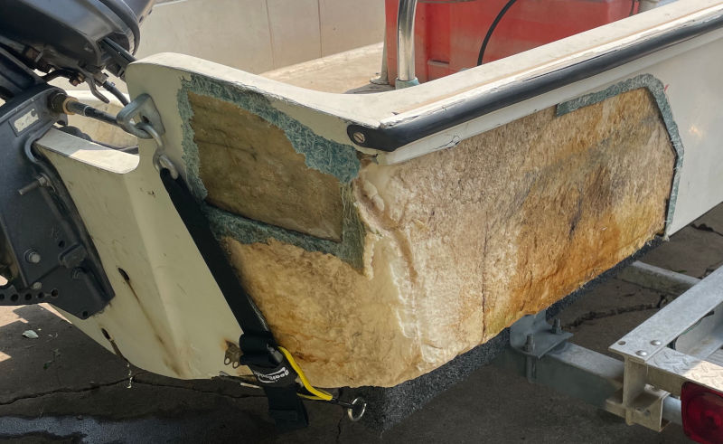

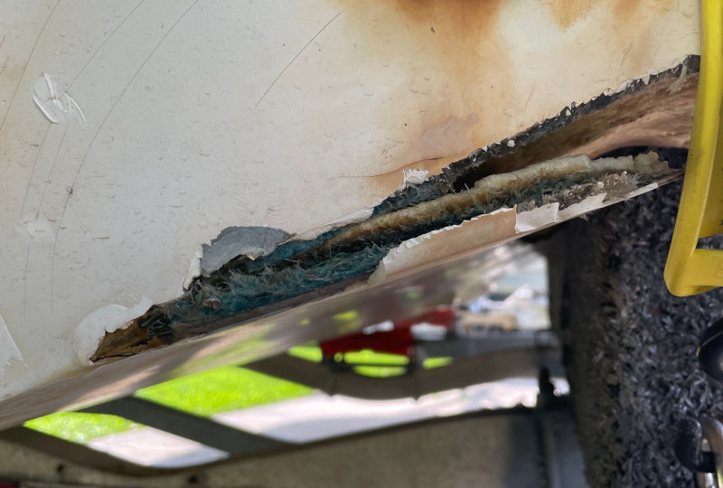

Postby AggieDad13 » Mon Jul 22, 2024 1:52 pm
Two views of the damaged area of the 17-foot hull:
Fig. 1. Hull damage after original repair was torn away recently while boat was operating on plane.
Fig. 2. Close-up of transom to hull bottom joint showing separation of laminates from foam core and each other.
Fig. 3. Close-up view of hull damage on bottom, showing torn away laminates and exposed foam. Note the rather thin laminate layer.

From what is shown in Figure 1 there appears to have been a proper grinding and tapering of the original laminate at the joint-line of the repair when the repair was made back in c.2008. You see this in the bluish area that is several inches wide on the perimeter of the repaired area.
The almost rectangular area on the upper transom suggests to me that perhaps there was wood reinforcement there.
Figure 2 shows that the gel coat and underlying laminate where the transom meets the hull bottom has fractured at the bend line. This appears to be new damage to the hull that was not previously repaired. Note the small section of gel coat resin that remains intact shows how the thickness of the gel coat was increased in this concave curve in the mold. Gel coat resin in not particularly strong as a structural bond. The deeper layers of the laminate look like only chopped fibers. Laying up the hull with some woven cloth for this areas would have been a better build option.
The bottom laminate also appears to have separated from the Unibond foam layer.
A proper repair will require adding back missing foam. One way to do that would be to remove more foam to create a uniform depth of missing foam, then glue in place (with strong adhesives) new foam in a series of squares or other shapes cut to fit the necessary area of repair. The new foam should project to just below the prior lines of the hull. Then new fiberglass cloth can be laminated onto the foam. For best adhesion, a marine epoxy resin should be used.

Added third image ( see Figure 3 above) showing close-up of damage to the hull bottom.
Figure 3 shows just how thin the hull laminate layer actually is. What is being seen is that a Boston Whaler boat is really a foam boat with a rather thin layer of laminates moulded around it.
Once there is any separation in the bond between the laminated layer and the interior foam, the laminate layer is no longer really a structural element, as it is too thin to have the necessary stiffness and strength. But that said, these hulls are quite able to last 50-years, as long as the laminate and foam remain bonded.
