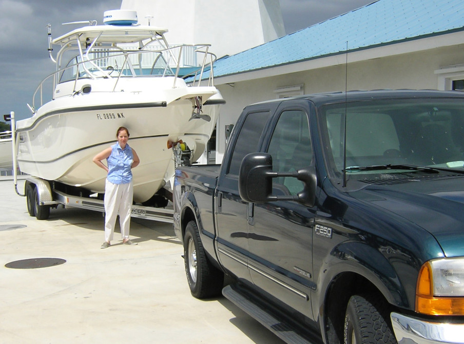

Figure 1 shows (what I believe is) a 2004 255 CONQUEST rigged with twin 150-HP engine on an aluminum bunk trailer, and being towed by a FORD F250 V8 PowerStroke diesel-engine truck. My wife Chris is in the frame to give a sense of scale to the rig. This set-up is quite a lot of boat to be hauling around on a trailer. Certainly an F250 truck would be appropriate, but whether or not the diesel engine is necessary would be determined by the expected length of trips on the highway and frequency of such trips.
Fig. 1. A very new 255 CONQUEST that came to the April 2004 Boston Whaler event held in Stuart, Florida at a Marine Max dealer there. Photo by the author.
Note also the excellent rigging on the trailer. The chine line of the hull is positioned just an inch or so above the trailer fenders. This puts the boat as low as possible on the trailer, keeping the center of gravity as low as possible. Also when trying to launch the boat from a sloping ramp, carrying the boat as low as possible on the trailer will help to get the boat afloat with the least submerging to the trailer (or the truck rear axle).
