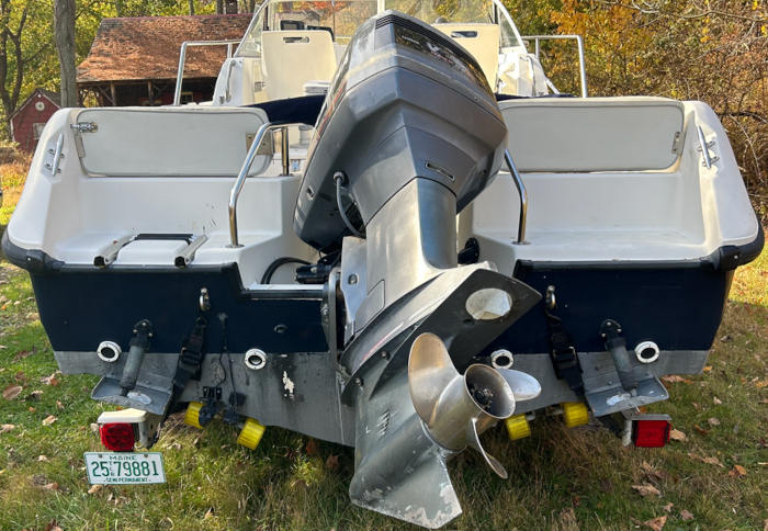

Fig. 1. Transom view showing left-hand propeller, the location of SONAR transducers, trim tabs, and floppy-roller trailer.

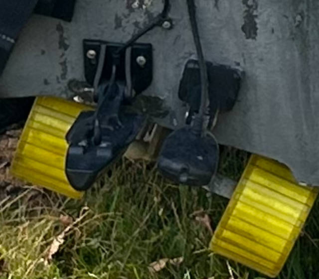

Fig. 2. Close-up of SONAR transducers.

Not to add to your misery, but in your two recent illustrations (Figures 1 and 2 above) the boat seems to be sitting on a floppy-roller trailer. Use of a floppy-roller trailer with a Boston Whaler Unibond hull boat is not recommended. This may be the most concerning aspect of this boat.

I don't know where you are getting the advice about which side of the transom to mount the SONAR transducers, but you need to recognize that you have a boat with an outboard engine. You may have read advice about where to mount SONAR transducers on the transom of boats that are powered by an inboard engine with a propeller shaft that locates the propeller forward of the transom.
With outboard engine boats, any concern for the stream of water coming off the propeller and having bubbles which might interfere with a SONAR is very much mitigated by the location of the propeller several feet AFT of the transom. A SONAR transducer on the transom which is two feet forward of the propeller will not be affected by any bubbles in the stream of accelerated and possibly aerated water coming off the propeller, unless you are making sternway.
Perhaps more important on outboard-powered boats is the effect of any hull strakes or chines on the flow of water coming off the transom. The SONAR transducer may not work properly if mounted in-line with a hull strake or chine.
