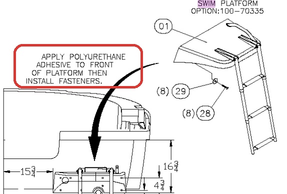

I had to take off the swim platform on a 2004 190 NANTUCKET to work on transom. The removal was [difficult].
I saw white adhesive on the entire surface area [of some part] as mentioned in Figure 1.
Fig. 1. Drawing

The drawing shown in FIgure 1 seems to give a rather generic specification for the adhesive to be used. See the text in the box with a red outline drawn around it.

At some point in the past, Boston Whaler was using Sikaflex as its "adhesive"
Sikaflex 291 is a one part polyurethane adhesive.

Yes, fishing braid - wrapped around two screw driver handles so I can use it as saw, and it worked really well. The adhesive was on the soft side, more like sealant rather than glue. I tested a layer of 4200, leaving it to dry up, and it seems same or at least very similar.
So I am thinking this what I’d use - thin layer of 4200 and assemble it back.
