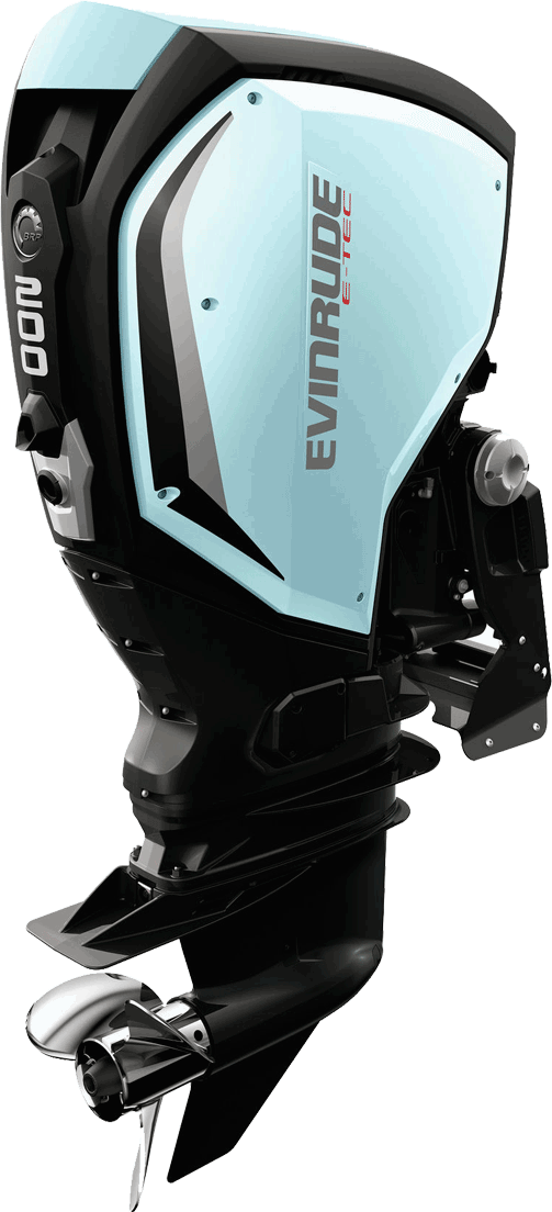

New E-TEC G2 models are 150-HP, 150 H.O., 175-HP, and 200-HP. They are built on a 2.7-liter six-cylinder [66]-degree V-block. They have digital throttle and digital shift remote controls and iTrim as standard features. They can have dynamic power steering as a very affordable option ($800). The rigging will be exactly the same as the larger G2 E-TEC engines.
These engines will have 30-percent improved torque compared to other 150-HP competitors, and continue the lowest emissions of any outboard.
These new engines only have 260 new parts. That is, they are built on the already tried and tested components of the earlier G2 models. The engine noise signature is improved compared to E-TEC legacy engines in this power range.
These new engines are ready to ship in about one week!
Evinrude G2 new V6 200-HP 2.7-liter in ICE BLUE color

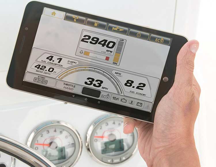

Evinrude also revealed a new product, E-LINK, which will share E-TEC G2 engine data over a NMEA 2000 network via WiFi to an iOS or Android device. In addition to displaying data, Evinrude E-LINK will provide remote control of i-Trim and Dynamic Power Steering settings. It will also be able to initiate auto-winterization. The E-LINK will mirror most of the data displays of the ICON Touch series displays. An E-LINK module sends the data back and forth via WiFi from the network to boater's smart phone.
More information can be found at
http://www.evinrude.com/en-US/accessori ... ec-g2.html
