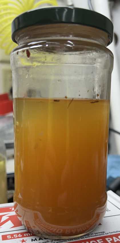

I opened the drain on the fuel-vapor separating filter. The fuel that flowed out was white and creamy. I continued to force more clean fuel into the engine and finally got it to run smoothly on a hose adaptor in the driveway. See Figure 1 below.
Fig. 1. Fuel taken from the engine showing phase separation between gasoline (upper layer) and an emulsion of water and gasoline.
gas from engine (1).JPG (31.94 KiB) Viewed 3167 times

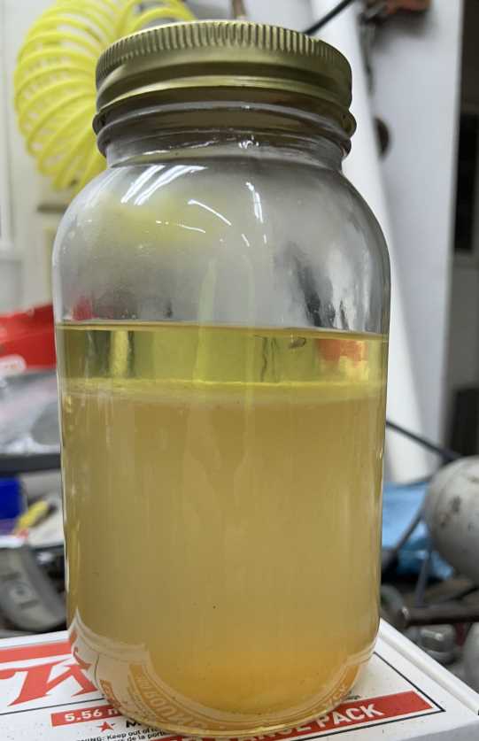

The next day I bought a plastic barrel from a feed store and began the process of draining the fuel tank. I extended the fuel line from the tank though the engine splash well drain and filled a Mason jar. See Figure 2 below.
Fig. 2. Fuel taken from the fuel tank. Again, phase separation has occurred, but now with three layers: gasoline, gasoline-water emulsion with sludge, and water.
gas from tank.JPG (31.07 KiB) Viewed 3167 times

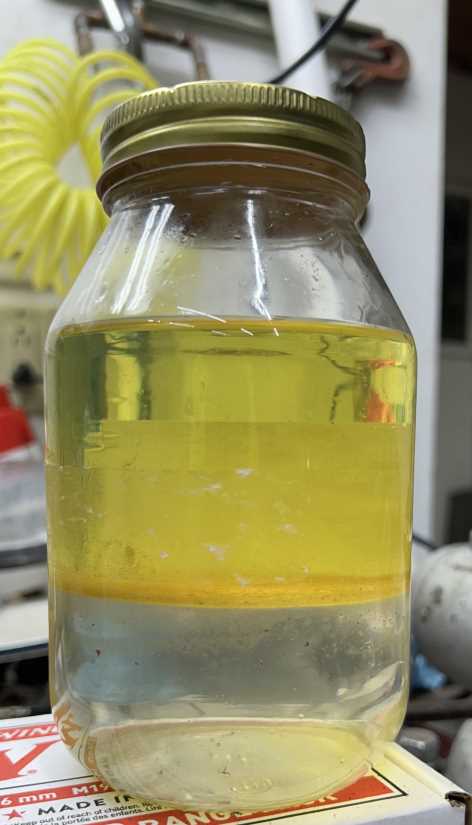

While I was watching the tank empty I decided to remove the RACOR fuel-water separator filter and check it out. I did not take any photos of the filter but it was rusty as can be. I did drain the fluid inside the filter and I use the term fluid lightly. See Figure 3 below.
Fig. 3. Fuel taken from the fuel filter canister. This liquid is contaminants that were blocked by the filter media from passing through to the engine.
gas from filter.JPG (24.42 KiB) Viewed 3167 times

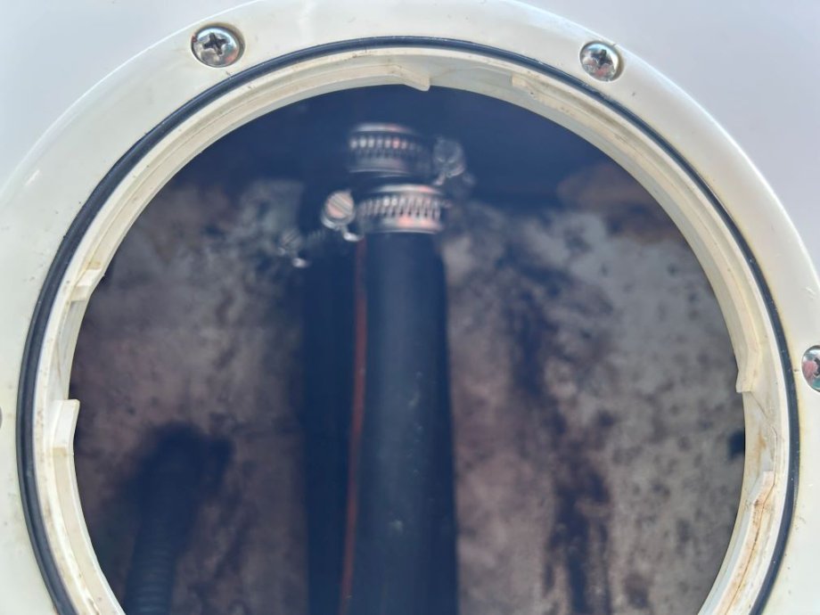

The fuel fill and vent hose at first seemed a daunting task.
The fill is located on the gunwate, seen below in Figure 4.
Fig. 4. A close up view of the fill fittings and hoses. The space is tight.
gunnel fittings close up.JPG (68.63 KiB) Viewed 2952 times

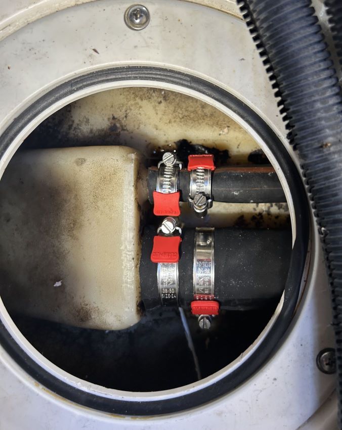

The tank inlets are located in the console below a 5-1/2-inch deck plate, shown in Figure 5.
Fig. 5. A view of the tank inlets and hoses inside the console.
console tank fittings close up.JPG (85.78 KiB) Viewed 2952 times

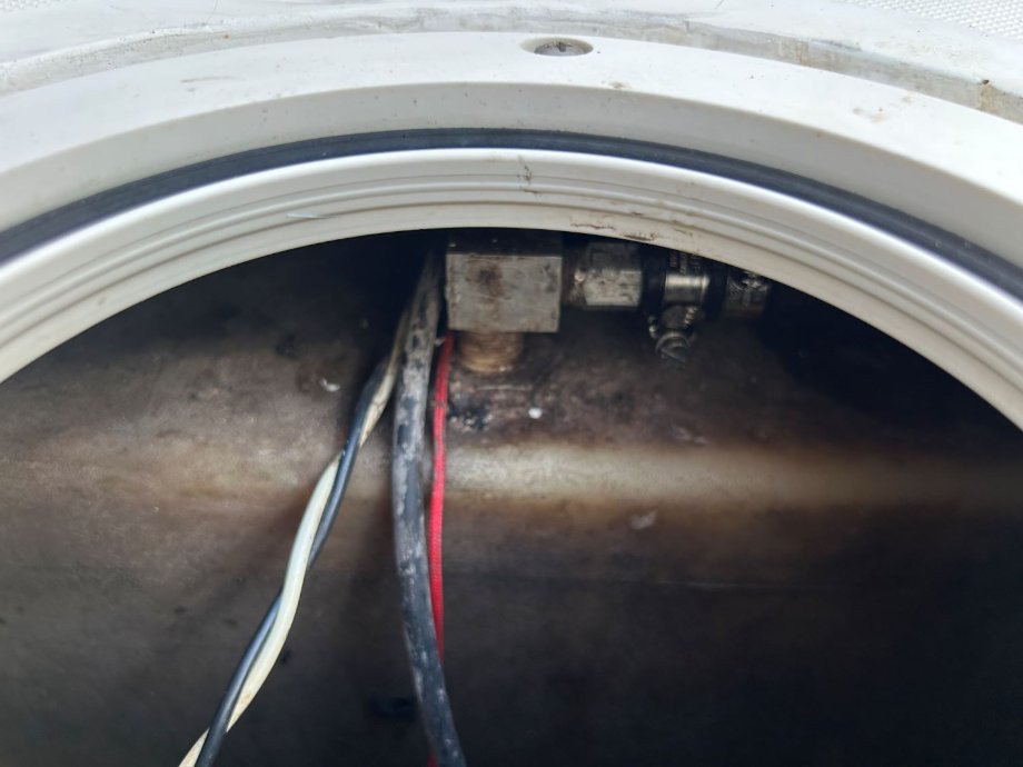

The next day I planned to install the 3/8-inch hoses from the fuel tank to the fuel filter. The tank outlet is located sort of under a deck plate in the stern of the boat.
Fig. 6. View of the outlet fitting and hose.
Workspace is much better there so I thought this would be easy. Not close. The fitting is located to the side of the deck plate, it was corroded and the hose eventually was cut off the fitting. Routing the hose was fairly easy if I put my whole arm through the deck plate hole. It should be noted that removing the deck plates is optional but highly recommended as any extra inch of hole space is proportional to the reduction in damage to the skin on your arms.
I also purchased and used a Milwaukee flexible inspection camera. Liberal amounts of RTV and deck sealant were used on this project also. Since completion the tank was filled, engine run and tested on the water for about 75 miles of operation.
